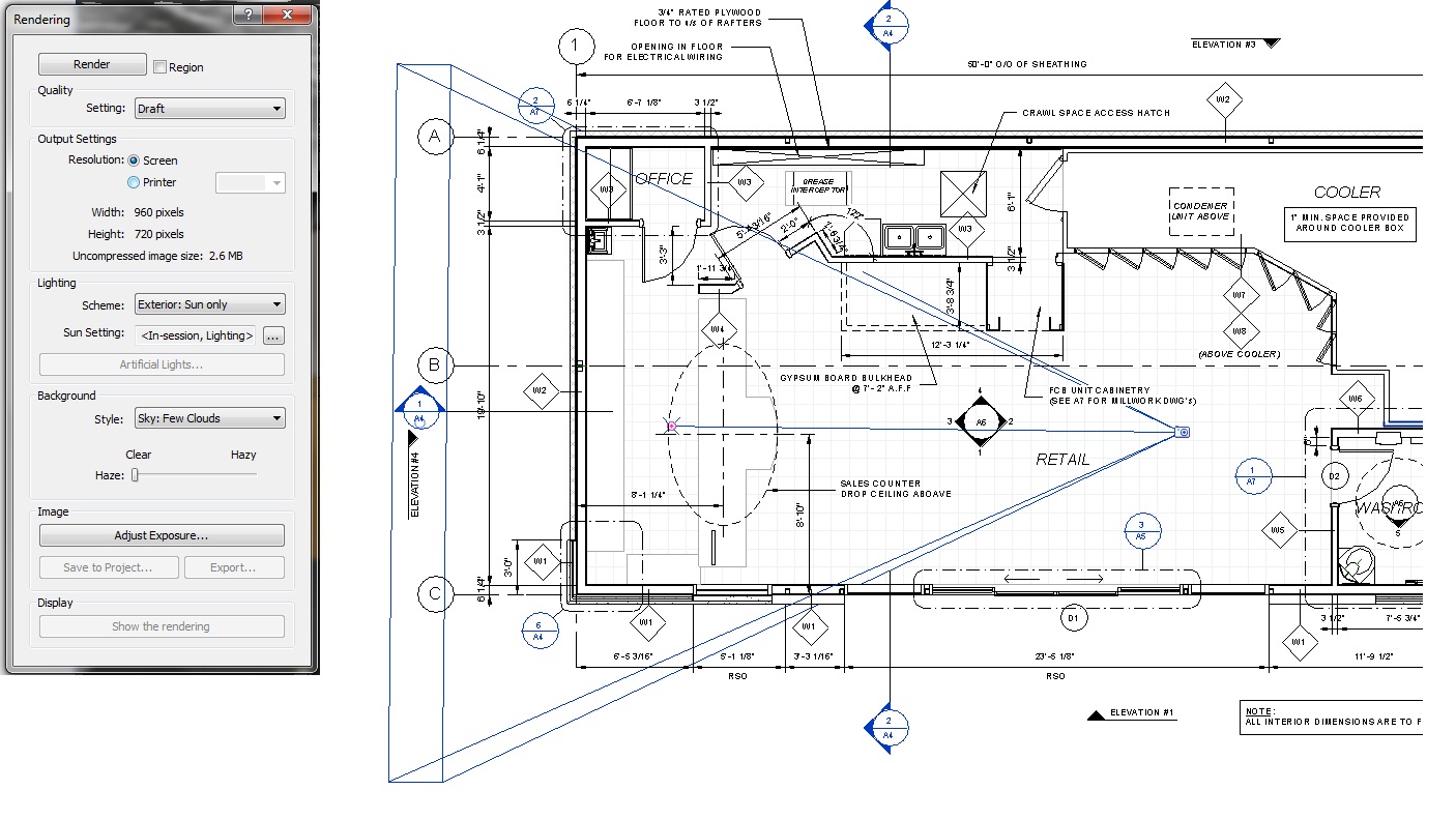

I'll reply to #3, open up your floor plan, in your brower find the 3d camera, right-click and hit show camera. The picture of the camera of obviously your location, the pink dot is your target and the blue box is your view range, try manipulating these points. Also please post your render dialogue box so we can see your settings.
