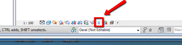

i HAVE A MEZZANINE SHOWN AS A FLOOR ELEMENT. It shows in all section elevation and floor plan views BUT when I go to the 3D view it is missing I have cheked all visibility checkmarks in th Visibility/Grpahics pull down and they are all set. Can anyonme shed some light as to why in all views it shows and 3D it does not?
Also in the 3D view my main floors show, but only the mezzanine is missing

Wierd... did you create that with the "floor" tool? not a "mass"?
Put some images of that 3D view...

I created it using floor. If I right click and verify properties it is defined as a floor. enclosed is screen shots

Didn't you "Hide in view" that element in that view? check that, click on "Reveal hidden elements"

Check the disepline setting.  if you used a structual slab and are not on coordination it may not show up.  Are you worksetting elements to seperate workseta?
