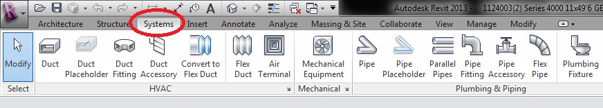

this is what my ribbon looks like, all MEP tools are under "systems"
This is the version of 2013 we received with our subscription; I didn't have to do any seperate installations.
