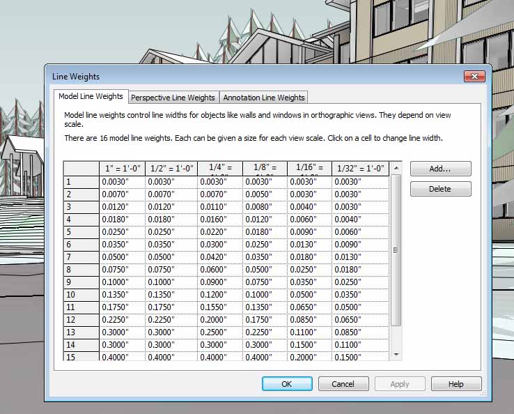

I have 6 or so lineweights that I use.  They're scaled so that they print at an appropriate weight regardless of the view and the scale.
In my Linetypes, I preface the line name with the weight of the line.  IE:  1_thin, 2_med_thin, 3_med, 4_med_heavy, 5_heavy, 6_very_heavy.

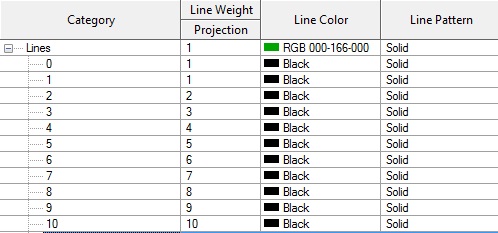

I have similar setup to 'itsmyalterego'; I have 10 line types to choose from and I simply list them as 1-10 with the appropriate lineweight.
