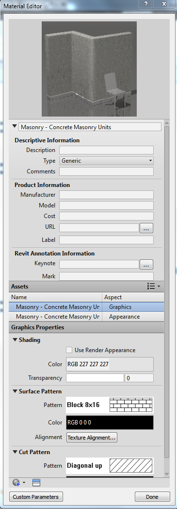

Where within the material editor is the Material Description that is tied to the Material tag?  This was readily available in previous versions, but not so much now.

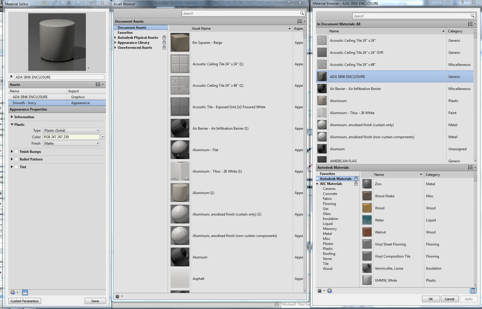

I'm not quite sure what you mean.  I have attached a photo of the 3 dialog boxes that you should see when opening up the material editor.

I'm having the same issue. There should be a description that will control the text in the Material Tag just like in 2012, but it doesn't seem to be there.

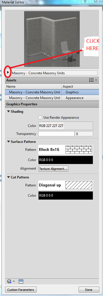

It is in your material editor.  See the attached.

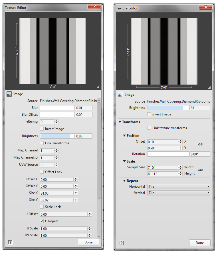

Im curious as to why sometimes my texture editor looks different. My intention was to change the bump material, it came in at a large scale so I went into 'edit image' and was met by the image on the left. I tried to change the size by it would not let, it'd just reset back to 7'. I closed the editor windows down right back to my project, re-opened the editor and was met by the image on the right. No big deal, I'm just curious about the variation, anybody else see this?
Thu, May 2, 2013 at 4:50:53 PM | Revit 2013 Material User Interface
sroreilly
Joined: Mon, Jan 17, 2011
97 Posts
I've been encountering this & wondering the same thing.... Seems very odd.
