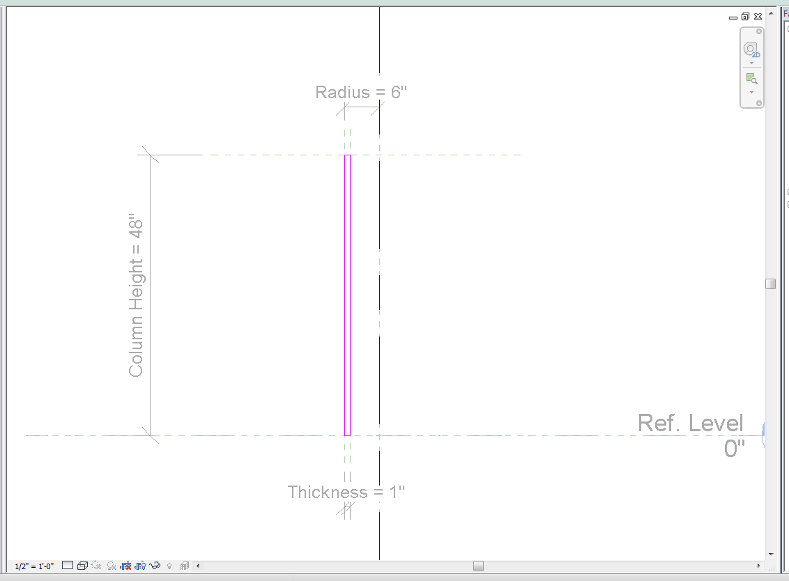

what if you did it as a revolve? set two vertical reference planes off a bit from the main centre line, then measure one from the centrelinei with your radius paramater, then measure the other one on the inside from the outside line with your thickness type parameter. Now you can just lock your revolve boundary to these lines.

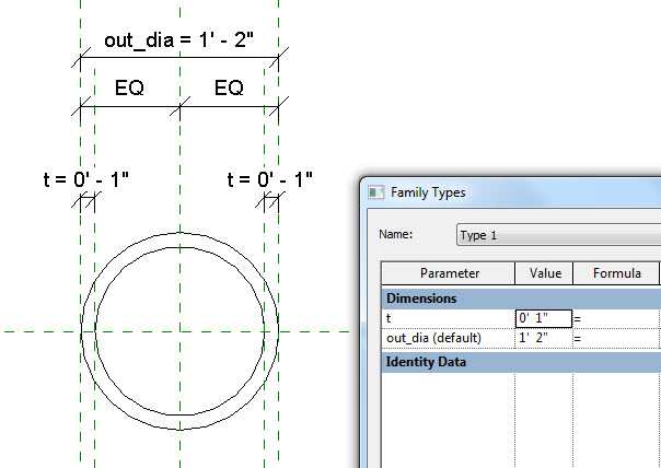

To control circles by diameter, do the circles as 2 arcs (with the center-end-arc tool). Make one instance parameter to control the outer diameter, and make one type parameter that controls the thickness, as shown in this image. No need to do any formulas, in my opinion. Set the different thickness values in different types. In the project, the diameter would be instance, and the thickness would be controlled by type.

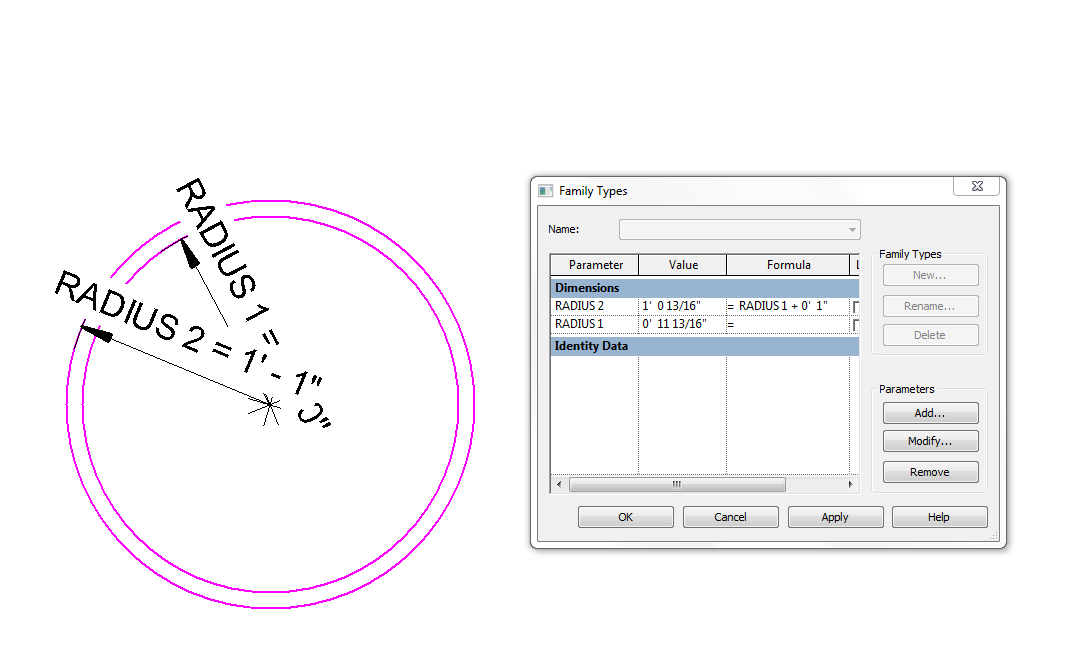

Another simple way to do it (using a solid extrusion and a formula)......

In my previous message, just the parameters on the top are required, not the ones on the left. I tried to replace the image, but something in the forum's settings did not let me replace it; it would keep on showing the old image.
This solution allows pull handles to control the diameter of the outer diameter, and a type parameter to control the thickness, as requested in the original post. Anyway, this is the new image that I wanted to post:

Thanks for all the good ideas. I used AbsoluteBIM's revolve idea and it works well for now. I'm still a bit confused on how to dimension the distance between two circles since aligned won't work, but I'll look more into it.
