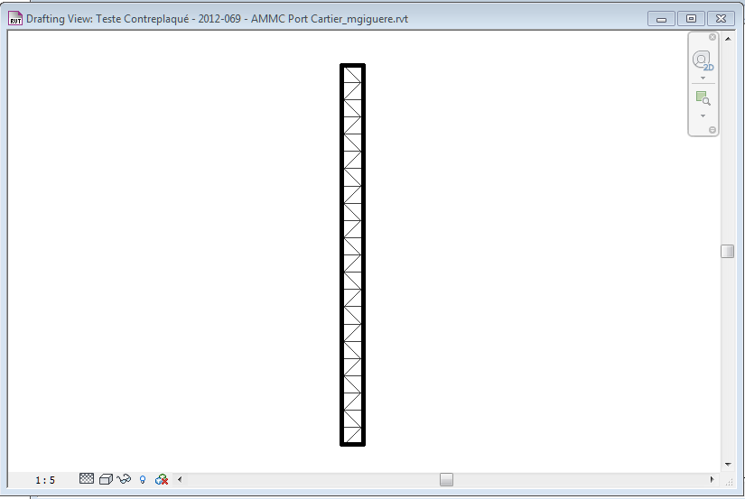

I made myself a plywood detail component using a filled region.
I made the lenght editable, so its easy for me to just make it longer if i need to when am drawing details.
The problem is;
I want the texture inside the filled region to rotate with my detail componen.
At the moment, even if i rotate the detail component, the texture inside it will remain the same.
So if i have a vertical plywood, the texture on it will be diffrent from the horizontale plywood.
thx for helping

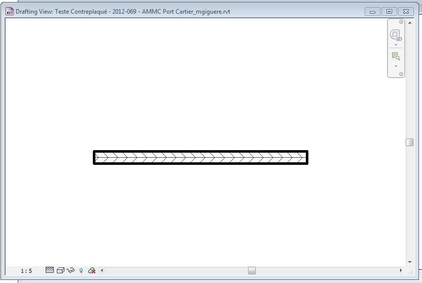

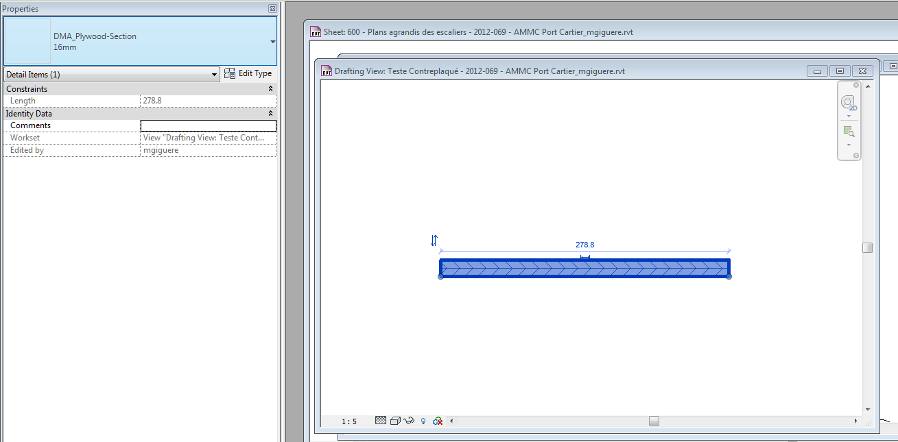

Ok so, since i dont have the answer am looking for am adding some picture tu help you guys understand.
So, this is my plywood familly:
First picture = The plywood familly
Second picture = The familly once selected
Third picture = The plywood familly after a 90° rotation
As you can see, the texture inside the familly dont rotate with the familly.
Note that all of those pictures have been took in a drafting view, so its not a 3D component.
In that case texture allignement cant be use, since its in 2D.
You guys can still tell me what you use for your plywood cut detail.
Thx

Thu, Jul 19, 2012 at 10:11:29 AM | How to rotate a familly and have its texture rotate with it ?
I use a model hatch, in a filled region, for my detail, plywood sections so that it can be rotated and adjusted.  I don't use the stock plywood detail element.

thx for your answer,
i dont know if i can put this in here, but here is the link that helped me to fix my problem
thx once again
http://forums.autodesk.com/t5/Autodesk-Revit-Architecture/Detail-Component-Fill-Patterns-Don-t-Align/td-p/2097112
