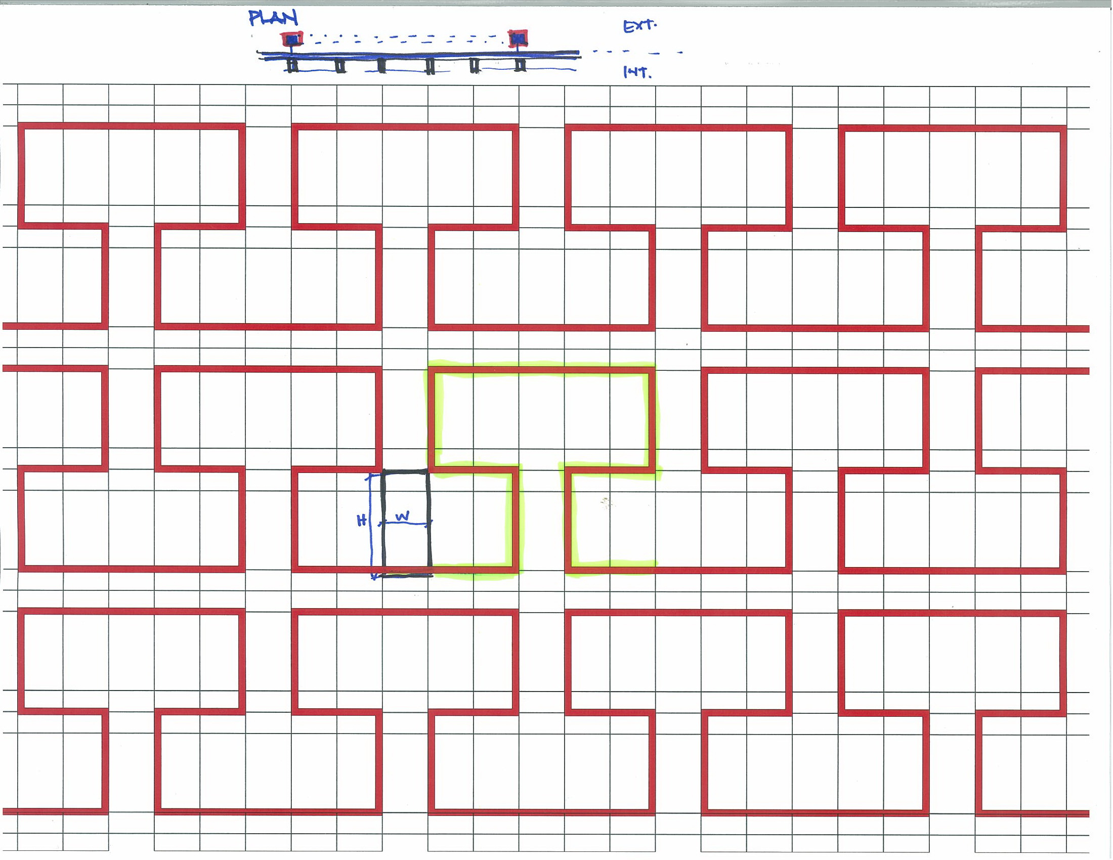

OK, I attached an image of the sunshade I am trying to make. I know there are a few ways to do it, but I would like to make it parametric so that it adjusts along with a change in panel width or floor to floor height.
The red pattern is 350mm off of the facade in plan. I'm not really sure what to call it, I guess a sunshade. I would like to make the portion of the shade highlighted in yellow, attached to the panel with a heavy black line around it. That way, I can give the shade a visibility parameter and turn it on or off if the pattern shifts.
I built it so that whatever the dimension 'w' and 'h' are, the shade goes right for 2w, then up h, then left 2w, up h again, etc...
I built it and pushed and pulled the width and height around in elevation, and everything adjusted as needed. It's just not quite perfect in the project environment, though. Back in the family editor, when I try to adust it in the Family Types box, it won't let me, and I think that original framework of 'w' and 'h' is the reason why...
Tue, Jul 10, 2012 at 1:55:11 PM | Trouble with curtain wall panel parameters - 2013
If those elements are all fixed dimensions, then you can use an array on those, your problem is on odd sized panels where you may need a filler on each end.
Search through the forums and you will find many discussions on arrays in families.
