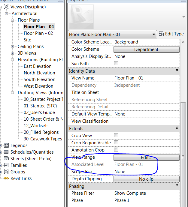

What determines what level everything is inserted on?
I have a small residential project in Revit Architecture 2012 with 3 levels- footing, which is -12" from grade, Level 1 walls, which is on grade to 8'-0", and level 1 top plate at 8'-0". Everything I insert into my level 1 floor plan goes to the footing level. I thought when I change before insertion that would make everything from then on insert into the level I set it at till I change it again but this is not the case. I'm having to insert all walls, plumbing fixtures, casements, doors, windows, and then go back and raise them up.
Thanks,
Phil

How did you create your level plans?  It is not just a name.  You have to create them from the level using the view tab.
If you did that correctly, then did you change the work plane while in a view?

When you look at the properties of the levels that are not working . . . . what is the 'Associated Level'. The floor plan is the 'view' not the level (although they are highly related. See attached image.
Try making a new view floor plan from the view tab and use the correct level. If the level does not show up in the list it meeans there is already a floor plan of that level and you will needto 'duplicate'.

Thanks guys. Sounds like the answer(s).
