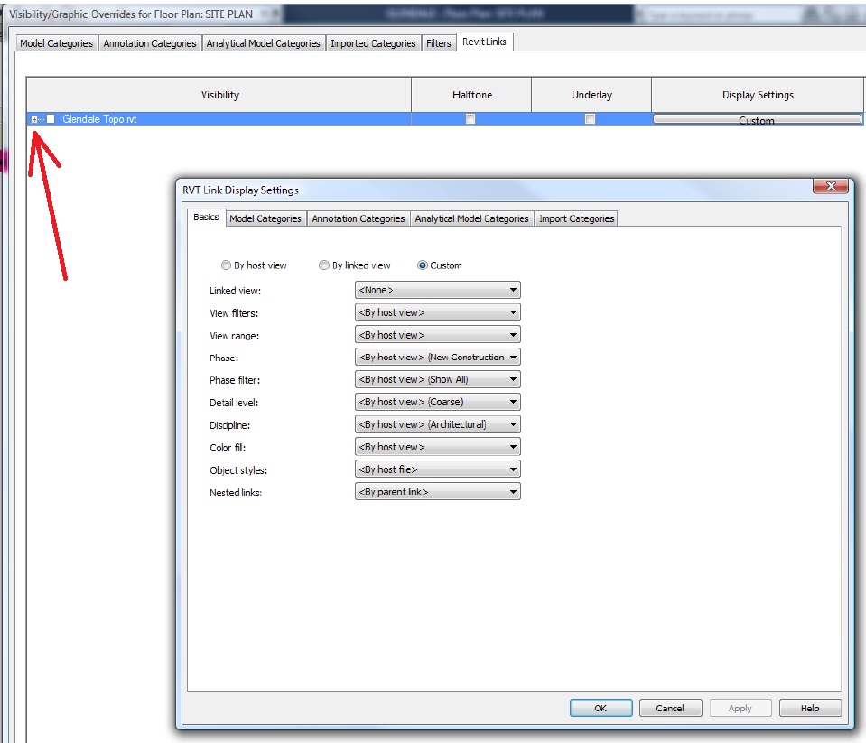

main Project file : Site plan has a linked contour topography revit file .
My 'VG' column for Overlay/halftone in Site plan window is UNCHECKED.
But I am not able to see the contour lines at all. not even grey lines.
The countour is visible in the "hidden elements" window.
But after selecting the topo , when I click on "unhide elements " or "unhide category", THE TOPOGRAPHY LINES do not become viisble in view, in short, unhide does not work on this.
FYI: The linked countour is visible in all other windows, ie, sections, plans, elevations and views.
What should I do to solve it?

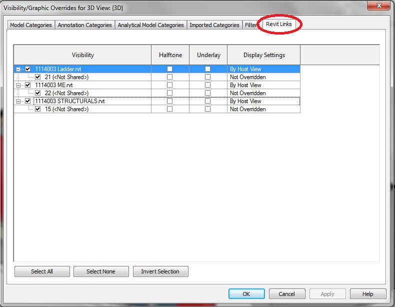

try going back into your VG settings and go over a few tabs to Revit Links, your linked file should appear here. Verify the the display settings are set to "by host view". Also be sure to expand the link if the little plus sign appears, ensure that the little check box are marked.

The problem is not yet solved!
I have attached a few screen shots to help explain the problem more.
I am stuck up with a submission over due!
I would be happy to share the file via mial/ dropbox (size @ 20 mb)

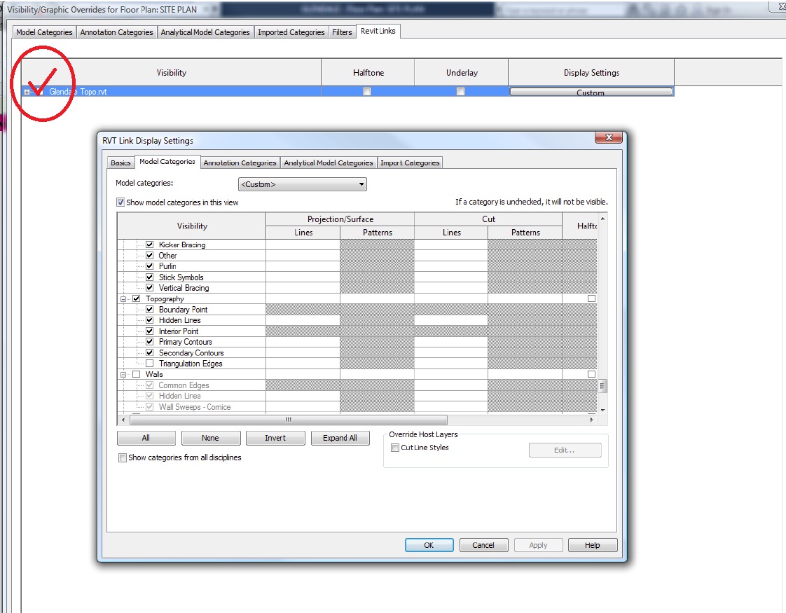

as I mentioned in my previous post, try marking the check box for the link so it appears...see attached.

I appreciate your suggestion.
I tried this right now.
It did not solve the issue. :-(

did you try expanding the link? hit the little plus sign, there may some sub-items, make sure these are all checked ON.
