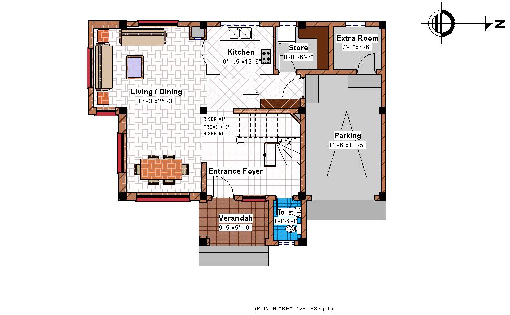

In revit architetutal 2012
in ROOM command
when i choose fill pattern/solid fill, it is ok
when i choose fill pattern/texture,  fill pattern is above the furniture
i have attached one image.
Have any solution?

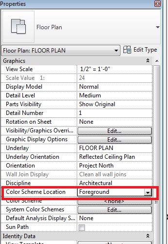

try changing your colour scheme location, switch to Foreground or background

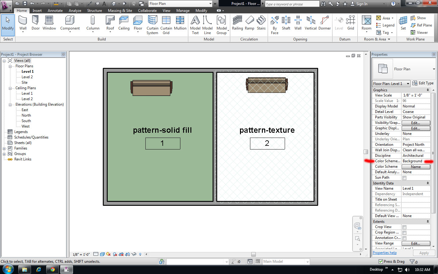

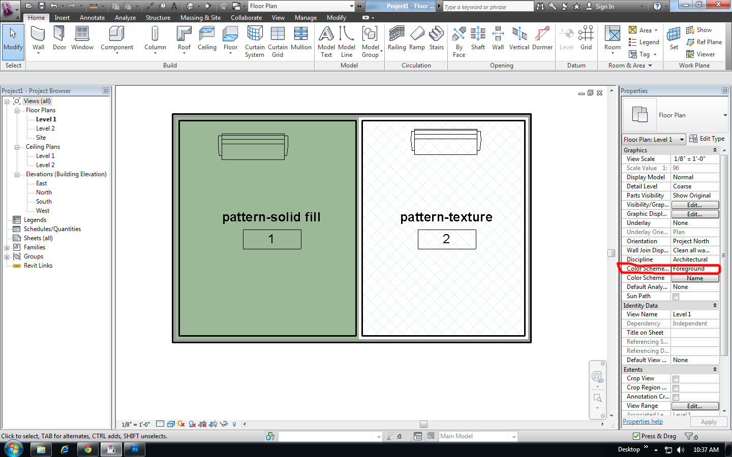

thanks for reply
i change color scheme location foreground and background
but it does not work
I have attached 2 images
1. color scheme location foreground
2. color scheme location background
have any another solution ?
108649_color_scheme_locationforeground.jpg108649_color_scheme_location-background.jpg

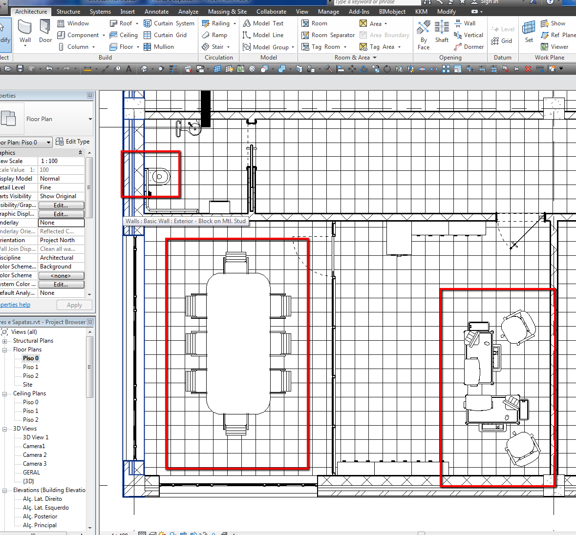

The problem is in your families and not in your "color scheme" plan
Color Scheme- Fill Pattern- Lineweight
