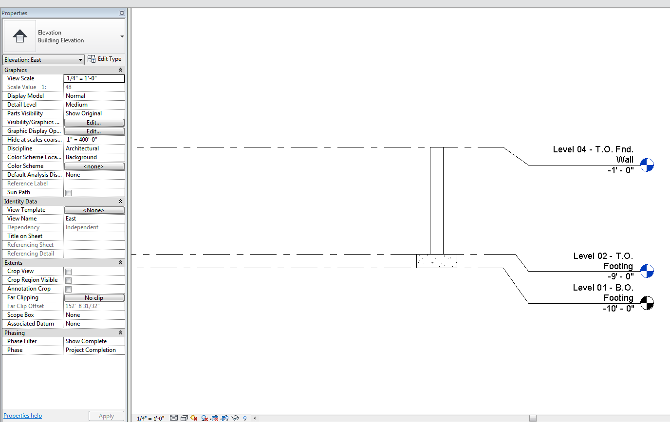

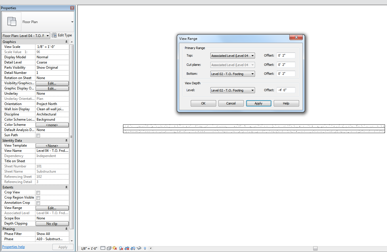

I don't know if I am missing something in 2013 but I can NOT get my foundation lines to show up hidden.  I set the bottom cut plane to just above the footing and the view depth to just below and the lines are showing as solid.  Any ideas on what I am doing wrong?  I haven't had this problem before so maybe its just me messing something up today.

is your <beyond> linetype set to a hidden linestyle?  also double check your view ranges or try setting view depth to unlimited.

YOU NEED TO HAVE A FLOOR/SLAB GOING OVER IT SO THE FOUNDATION LINES CAN GO FROM SOLID TO HIDDEN
