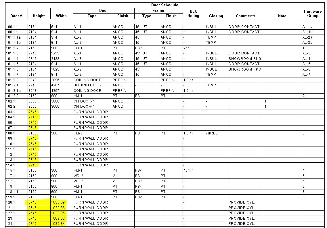

Hi there,
Revit 2012
I have got my Door schedule to a point where it looks quite useful. I made most of the fields simply text based since there were so many variations. As for Height and Width, I did use the benefits of revit scheduling. Although I am calling up some furniture wall doors in the schedule but I don’t want to show their Height value (the width does not always show up) I did not build the furniture wall door family and I used a curtain wall system to put it in the model which seems to work quite well. But Now I have many furniture wall doors where just the height shows up.
Could I get some advice as to how to override or hide individual fields within a schedule without deleting the actual door? Or could somebody describe how to control this within the family?
Thank you very much in advance.
Wed, Jul 4, 2012 at 8:24:49 AM | Scheduling override individual fields?
It sounds like you've got a real mish-mash...
Do the "furnature wall doors" really belong in this schedule or should you filter them out and put them somewhere else?  I really like to use curtain walls for curtain walls or windows.  But a lot of people do just what you have done.  I would have made them a special family in the correct category.
There is no way to over-ride the height data field.
Curtain wall door widths always show up unless something else is here that you have not told us.
