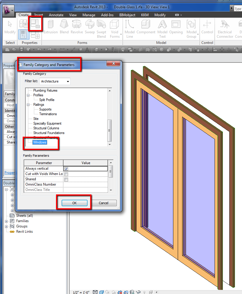

Hey guys,
I have looked everywhere and cant find a bi fold window....
Does anyone have one they could send would be much appreciated.
I was thinking of just using a bi fold door and changing the size but then it will be in my door schedule and not the window...
Thanks,
Jamie.
Revit 2018........
Mon, Jul 2, 2012 at 4:33:53 AM | Bi - Fold windows...
Joined: Tue, May 22, 2007
5921 Posts
4 Stars: 205 Votes
"I was thinking of just using a bi fold door and changing the size but then it will be in my door schedule and not the window.." - You can change the category of that family, just open that door family, goto "family category and parameter" and change to "window".
Mon, Jul 2, 2012 at 8:24:37 PM | Bi - Fold windows...
Jamie351
Jamie351 Avatar
Joined: Mon, May 23, 2011
124 Posts
4 Stars: 7 Votes
ohh worked perfect. Thanks heaps much appreciated.
