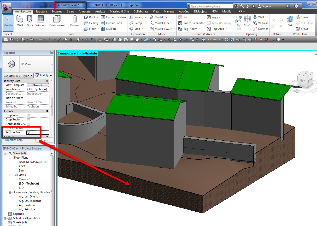

Activate the "Section Box" in that view...

with the section box on, you can adjust it to "cut" the topography. then you hide the section box in view.
