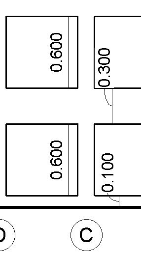

hi, well i have a project which we need to indicate the beam's width and a space between them size.
so what i cant figure out is how to show the dimension without the lines. i just need to show the number.
for example, the 0.600 is the width of the space between beams, and the 0.10 or 0.30 is the beam width on its left, i will use a keynote but i already assigned a keynote to beams indicating letters, for example C
can somebody help me? my client for some reason needs it that way

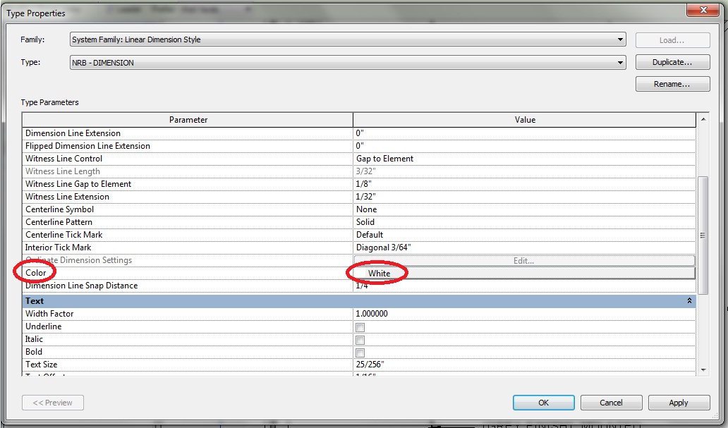

so your just trying to hide the dimension line but keep the number?
could you just change the line colour to white?
