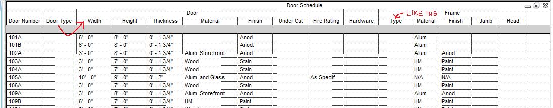

Hello,
I am trying to add a door type subcategory under the "door" section of the door schedule similar to the type category under the "Frame" Section.  (see attached image)  I have also tried making new schedules with subcategories like this but haven't been able to figure out how to do it.  Any help is greatly appreciated!

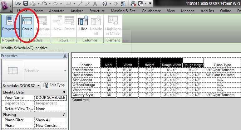

if I understand correctly, you've created a new parameter and just want to move it underneath the door heading, right?

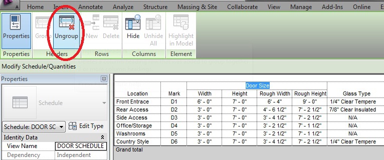

first click on the cell containing "Door" and then click Ungroup
Now click and drag to select all the headings you want together and then click Group
Now just type your desired heading back in.
Its kind of like unmerging and merging in Excel. Hope this helps.
