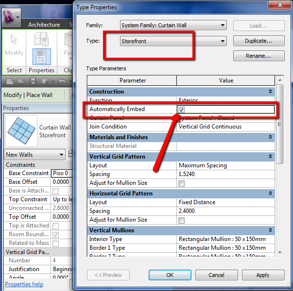

I am using Revit 2013 and trying to insert a storefront into a generic 12" wall. It keeps telling my highlighted walls overlap. Doews anyone have an idea why it would be doing this? I have never had this problem. Thanks

Turn ON "Automatically Embed"

I just went and done that and it is still telling me the same thing, any other suggestions? Thanks

I can draw a wall out in space and it works fine, could it be becasue the current walls were originally modeled in Revit 2012?

Works fine for me... watch the video: http://screencast.com/t/rrMgT8vJE1jc

Just create a file in 2012 with only one wall, save it and opened in 2013, create a Storefront with Autom. Embed and no problem...

Ok, That worked great, Thanks!
