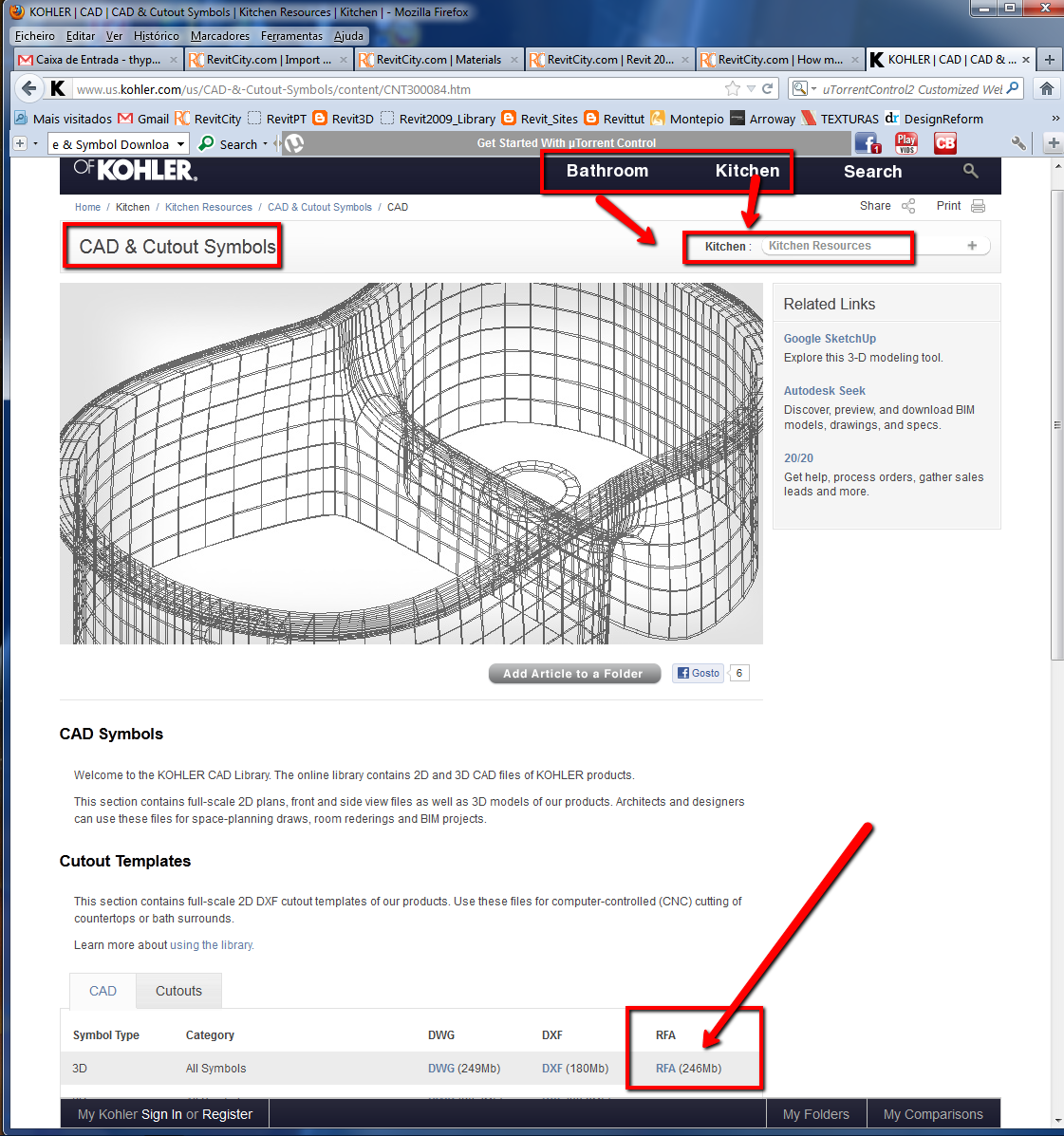

Fri, Jun 29, 2012 at 4:54:59 AM | Materials
Joined: Tue, May 22, 2007
5921 Posts
4 Stars: 205 Votes
You can download all RFA families (kitchen and bathroom) here: http://www.us.kohler.com/us/CAD-&-Cutout-Symbols/content/CNT300084.htm
