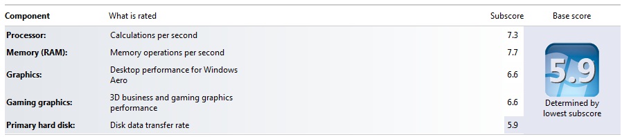

can you post details about your system?
maybe even refer to your systems 'Windows Experience Index' similar to the attachment. Sp;ecifically the Gaming Graphics category.
This is for my work system and everything works fine, my home PC has an inferior graphics card and operates similar to what you're describing.
