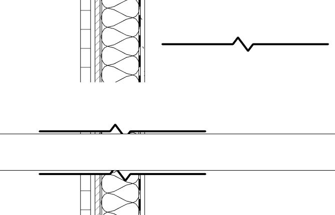

Revit allows us to break  Crop Regions up into multiple view breaks, esp. useful for tall wall sections.
Revit also has a nifty little break line that would be perfect for showing where view breaks start and stop.
It would be perfect, except the view break eats the break line.
If I go into paper space to apply the brek line, Revit disables annotation detail components. (eg break lines.)
Is there some way to actually use break lines in this kind of a situation?

Rotate the upper Break Line 180 degrees,
pull the splitted crop regions back far enough not to clip the zigzag,
turn the crop region visibility off.
Does that work ?

That works perfectly!  Thanks so much for your help.
