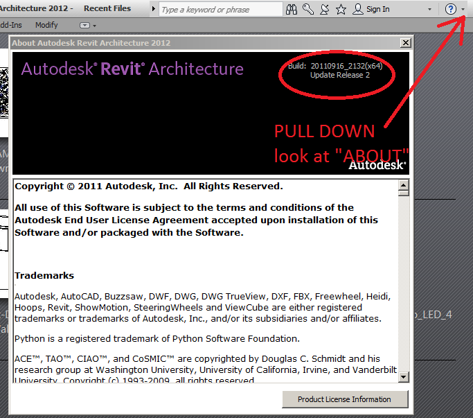

Fri, Mar 21, 2014 at 9:56:20 AM | finish edit mode tab issue
Look here:
If you have installed 2014, that messes up a dll used in 2012 and that has to be replaced.

Fri, Mar 21, 2014 at 10:43:38 AM | finish edit mode tab issue
#9
You don't show us that you installed your updates..... Please don't post again unless you show us that.
