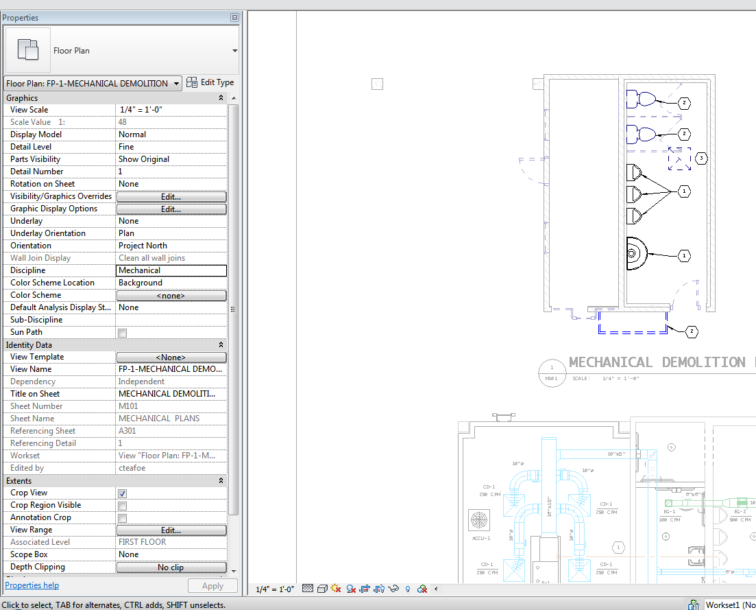

I have a mechanical plan which is set to the Mechanical Discipline and the architectural elements (walls etc) are showing up light which is good but they are showing up a little bit to light.  I can change the discipline to Coordinate and that makes all of the lines the same darkness which isn't what I want.  Is there a way to change the architectural/other disciplines to show up just a bit darker when the mechanical discipline is being used?
I attached a photo of my settings and plan.

Not sure but isn't this your halftone settings?  Manage tab/additional settings - halftone & underlays

Thats it thanks!
