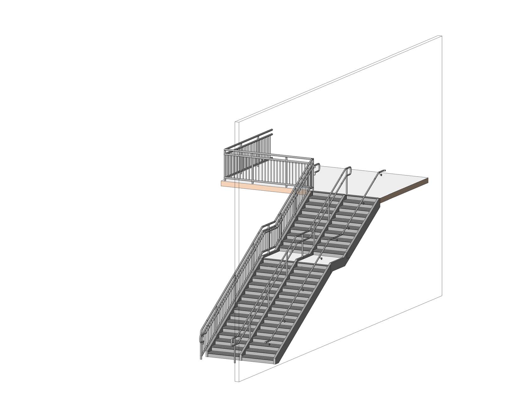

How do I add an additonal handrail at 36" onto the existing 42" handrail?

Edit your rail type, under Construction edit Rail Structure, add a rail at your desired height, offset, Profile and material

Is this what are you looking for?
In this case, you have to create a new railing with brackets.
Rvt 2013 Handrails for 3-run stair
