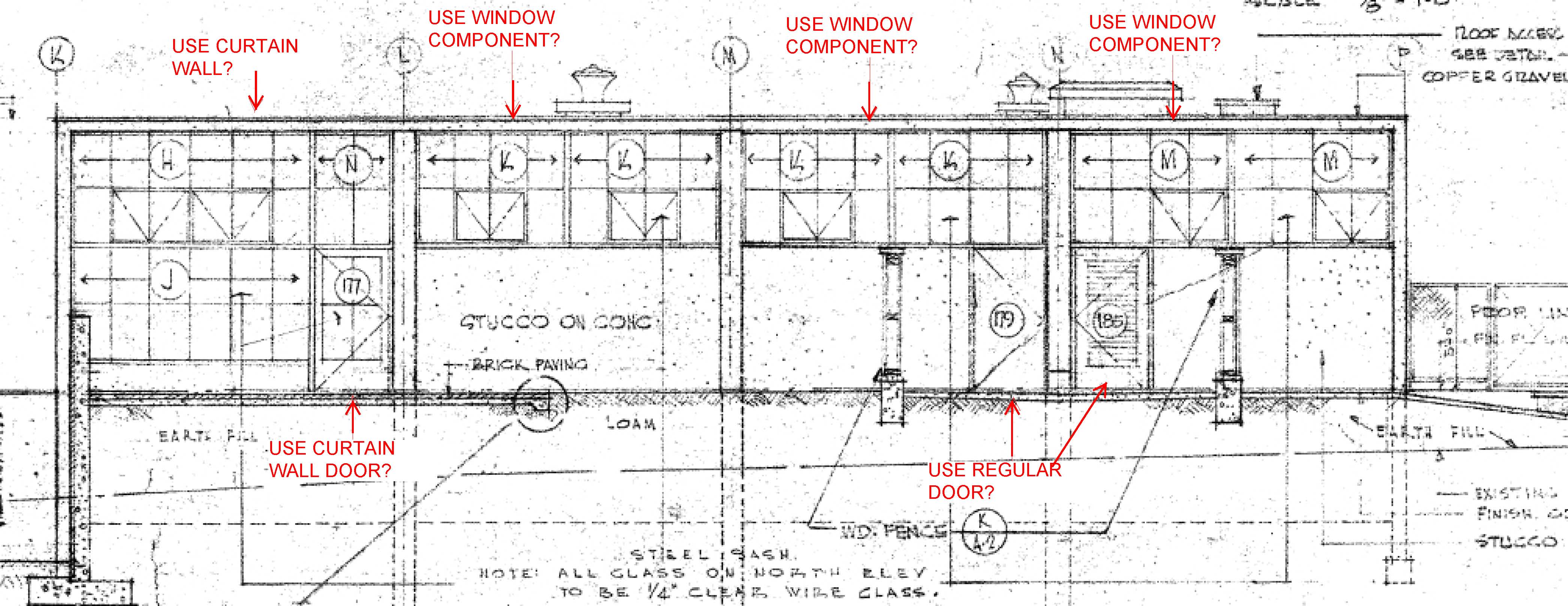

Can someone explain the differences and benefits between using a curtain wall vs. window?  I've been using a lot of window components for exterior windows I'm building as-builts of, but I'm starting to think maybe I should use curtain wall system for some of them?
I attached an image with markups.  Any comments greatly appreciated!

This is so nicely gridded out that I would probably use a curtain wall for everything. But it's also nice being consistent with windows vs. curtain walls for scheduling purposes in a typical scenario.  I've caught people editing wall profiles to leave a 3x4 void to fill with curtain wall instead of windows.  BAD.
