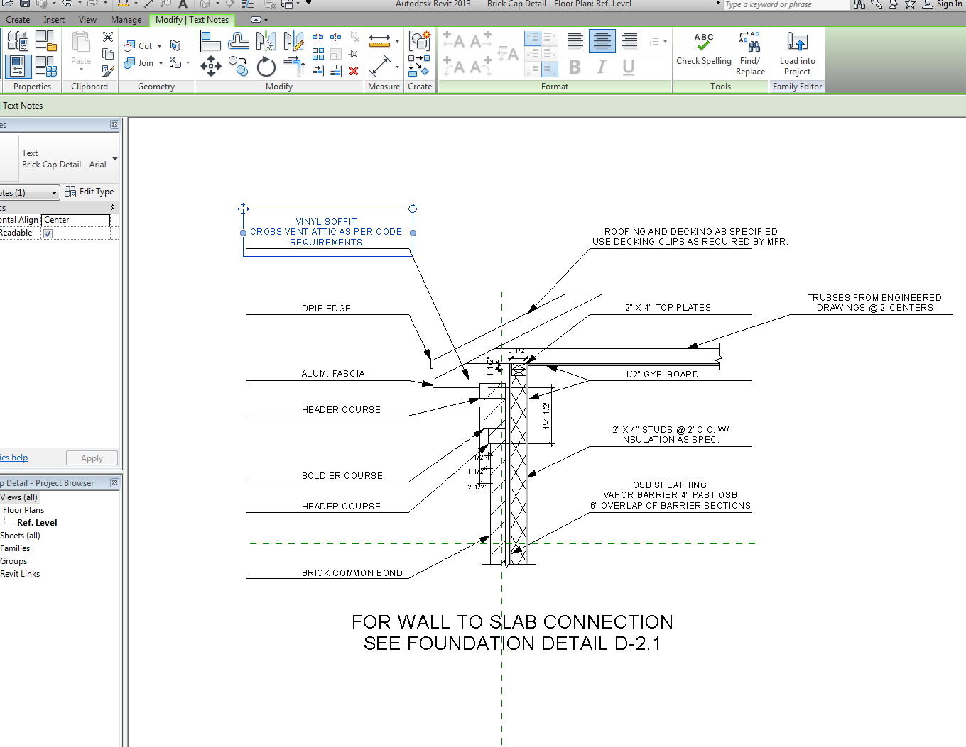

Im still in the detail family i created, i went to Create> Text> Under Properties i selected New Text> then Edit Type > then i gave it a new name and size. THats all i did, then when i click the text it wont let me select the Text with the leader . . .
Thu, Jun 21, 2012 at 2:55:05 PM | Inserting a 2D Component into a new project sheet
#14
ArchCheerios13
Joined: Thu, Apr 12, 2012
34 Posts
5 Stars: 1 Votes
Heres an attachement of what it looks like
Thu, Jun 21, 2012 at 2:56:14 PM | Inserting a 2D Component into a new project sheet
#15
ArchCheerios13
34 Posts
5 Stars: 1 Votes
all the existing arrows are from when i imported it from ArchiCAD, so i want to get rid of those
