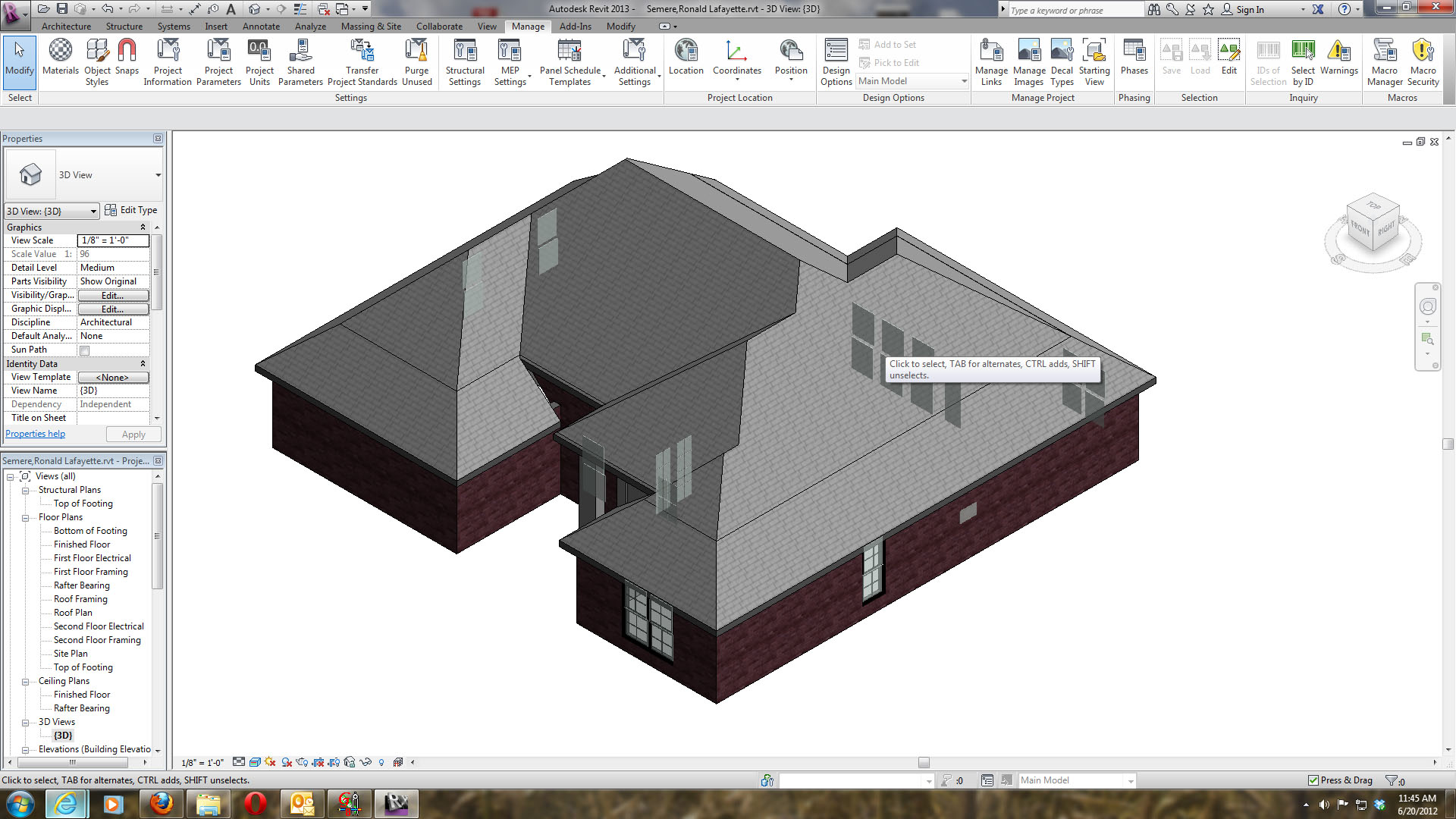

All the glass on my model is showing up though all the other matierals -- Even the glass on the oven or inside doors, windows and all of it!
Any suggestions -- Ive tried a few graphics/visiblity things --- I cannot figure it out.
Revit architecture 2013-- Used to not do it in 2012
Renders come out ok -- its just the different views between  realistic/shaded/etc.

I believe this is a trending BUG. There have been a few very similar posts here in the last couple weeks. It happens when you open a 2012 project in 2013. Not sure if there hase been any solution so far. It's not specific to windows or glass either.
Not sure if this Material Bug is related > http://forums.autodesk.com/t5/Autodesk-Revit-Architecture/Revit-2013-Material-Category-Bug/td-p/3438287
Maybe try turning off "Hardware Acceleration" in the Options > Graphics Tab. Could be video related.

We have this happening to one of our job dont know of a full fix. But just deleteing the 3d view and creating a new one is a quick fix.

We just saw this happen, turned off hardware acceleration and the problem was resolved. Video card driver was also out of date.
