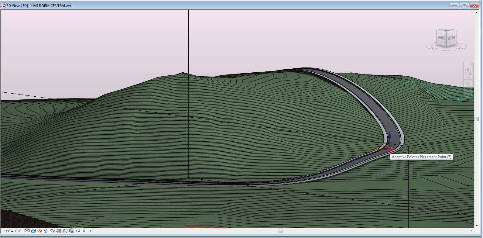

I thought some of you might find this interesting.  Today I made a family--a road.  Roads/paths have been a constant source of pain for revit users.   So lets call this a beta phase, and a preview.  When I upload the final version I want it to have more option and less quirks.
- 10 adaptive points on a spline define the path of a roadway and curbs.
- Independent on/off parameters for left and right curbs.
- Parameter to control width of roadway/path.
- Path is flexible in X/Y AND Z axis.
- No geometry edge lines or topo lines!!
HERE ARE THE QUIRKS/HOW TO USE:
- When placing the path points, they must first be placed horizontally.  Don't try to trace your road yet, just click horizontally 10 times...  Then rotate the system in the general direction of your road.
- Move the points to follow your road path. (May require hitting tab to select the adaptive point)
- IF NEEDED (especially along curves) rotate the adaptive point itself with the rotate tool so the X/Y axis are perpendicular/parallel to the road path, otherwise the width does not generate accurately since the profile is oblique.  The curbs also enjoy consistent perpendicular profiles.
-Modify Z axis in 3D view or elevation to fit your topo.
Enjoy--and criticism/suggestions are welcome.

Wed, Jun 20, 2012 at 10:27:10 AM | A solution for roads and paths

Very nice!  I just messed around with it a little bit and I'm curious to see how it works in an actual project, thanks!

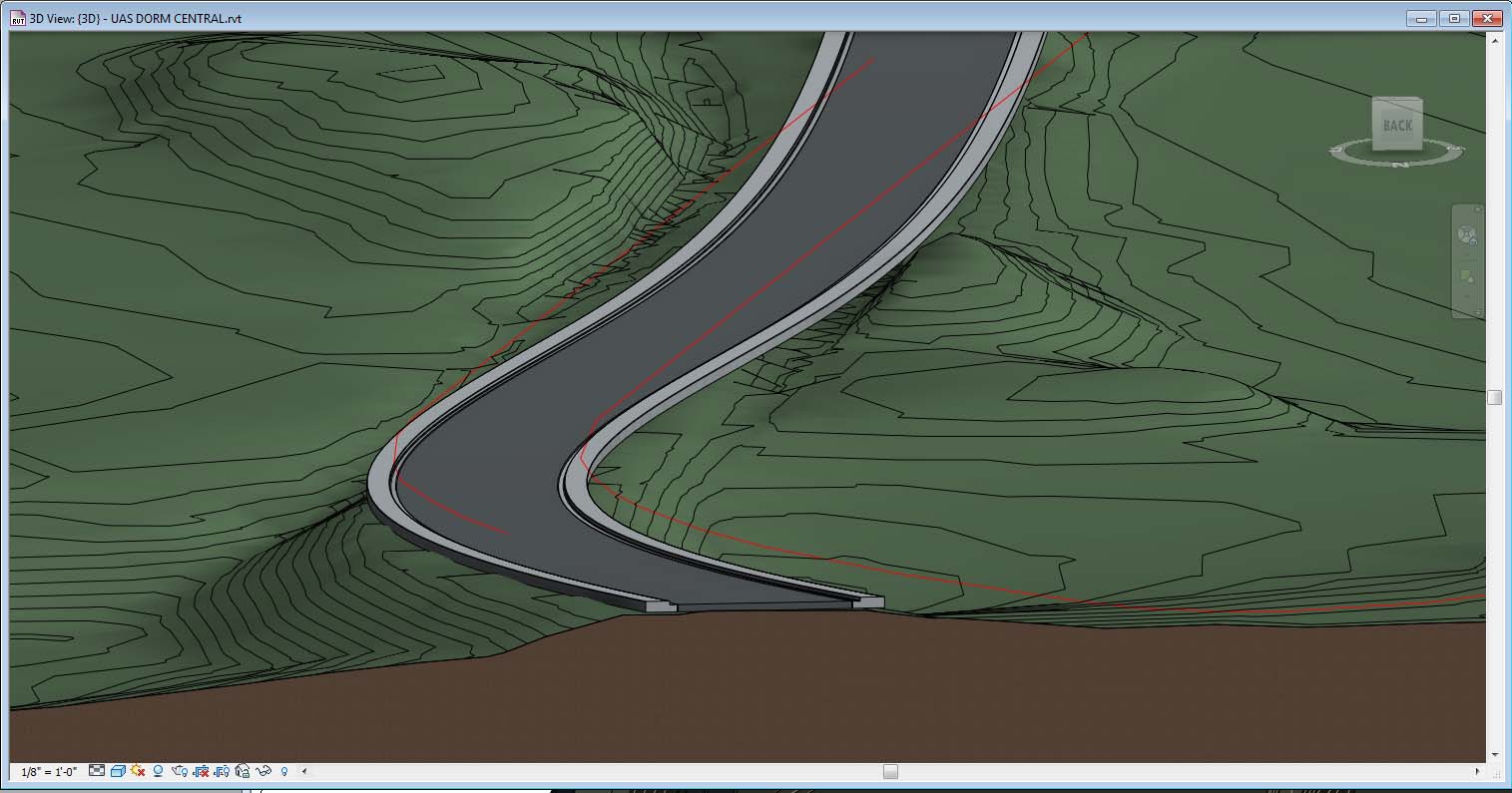

Here's a better picture, maybe.
I envision this as a surface treatment.  It will not cut the topography, so the site must be prepared for a road in one way or another.  However, it would be a simple matter to add a depth parameter to the concrete walks, to simulate a retaining wall, or to add another "embankment" feature that will slope down to grade and hopefully look like a built-up pad.
I'd like to add this because if people are like me, detailed civil topo is a luxury, and a lot of projects that need roads are in the conceptual phase where someone has to be sold on an idea and it involves altering poorly-surveyed and/or currently roadless ground.  So, good looks on bad and coarse topo.

Hi I have a few queries regarding the road family you have posted here. I am having some trouble in my job trying to create a road that will do what you have shown in the pictures you attached to this thread. I would love to use your road family. however I am having trouble placing the family into my project. When I place the 10 points like you describe and finish the task I get a pop up telling me that the family cannot be made. Is there something im doing wrong? When I place the points should I place on face or work plane?
Also, what family type templates did you use to make this family? A generic model adaptive? Sorry about all the questions. Looking forward to using the family you created. It looks great in your jpegs. great job!!

Hey--I kinda ran out of steam on this project and haven't really worked on it since this post.
Step one of my first post reads "When placing the path points, they must first be placed horizontally.  Don't try to trace your road yet, just click horizontally 10 times."  and this is probably the cief hangup.
I would suggest a conservative spacing, and try to stay horizonal.  when I say horizontal, I just mean from left to right in a plan view.  You shouldn't have to mess with work planes.  I'd just associate it with the nearest level.  (which drawing it in plan should do)
I used the Adaptive Mass template, which for some reason did not come with my revit 2012 install, and I found elsewhere on this forum.
hope this helps!
