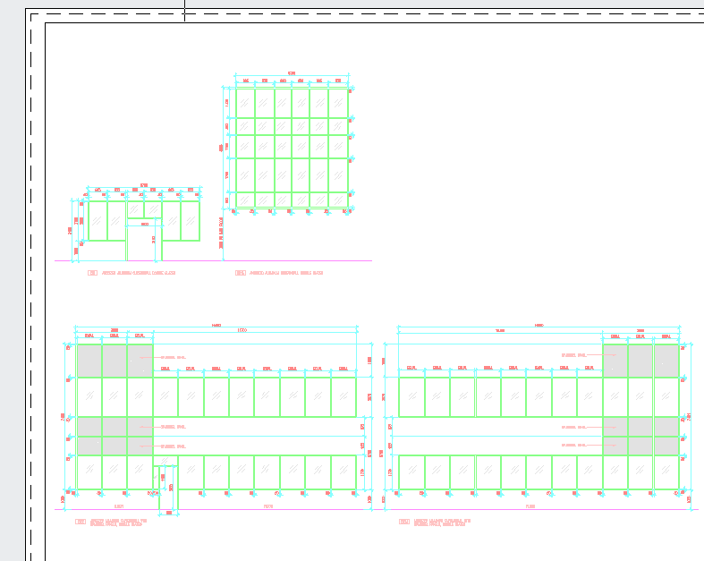

Hi, I am trying to make a exterior windows elevation for my curtain walls that looks like the attached picture. All the exterior windows are created with the curtain walls tools and I was trying to duplicate the exterior elevation then use crop region to split them up. But some elevation has too many windows and with odd shapes. They get to complicated to seperate. Anyone know any trick to do it

Why crop region?  When I do our CW elevations, first, I adjust my working elevation that I call-out from so the it is very shallow.  I set up a view template for this view that turns off all model categories in VG except walls and doors. Then I temporarily hide my CW and using a crossing, I select all other elements and hide in view.

thats what I did too, but I dont want to show all identical windows more than once and the spacing may not be what I want to arrange them on the sheet

I use detail callouts in this working elevation.  Those are the elevations I place and arrage on my sheet - not the entire building elevation.
