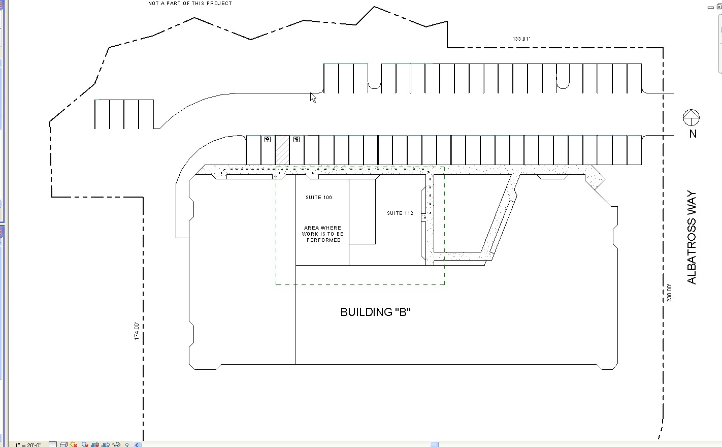

I did a site plan of mostly detail lines and all of my lines, (medium lines), are plotting grey. Where would I look to change this. The line weight is set to 4. Not sure why they would plot this way. They display fine on screen. Thanks

Can you provide a screen shot ?

5 Stars: 1 Votes
Here you go

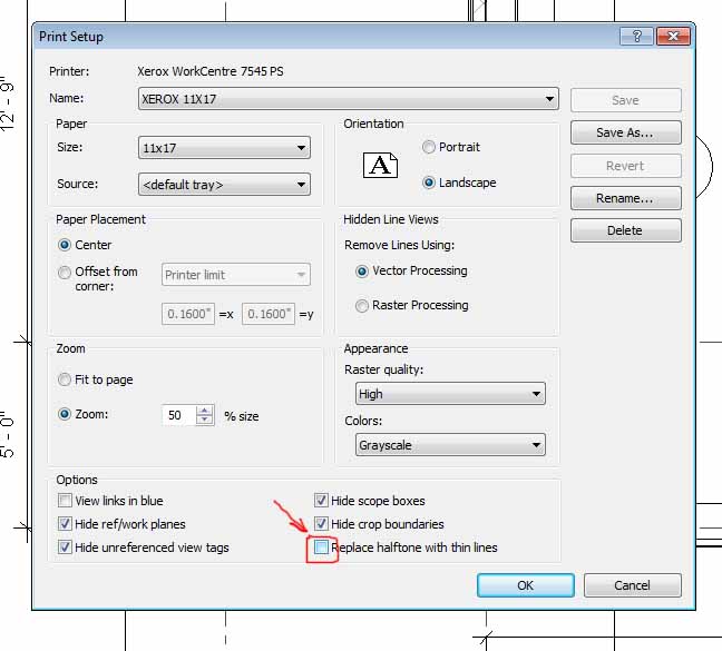

I'd like to see the legal description/coordinates of that property line.
I would first check and make sure that your line types/styles and object styles weights are actually what you think they are.
Property lines are not really in the line category--they're under the Site category, and might operate under slightly different rules, so it's not safe to compare them.
Also out of superstition I would duplicate the view and discard the old, restart revit.  Check to make sure the line color is black and not very dark gray...
...and for good measure, (although I know it's not your problem since no lines are overridden halftone) make sure this box isn't checked.  It was a common stumbling block in our office as people decided to go vigilante on graphics... I hate it.  two thirds of the requests for my time involve deconstructing the graphics settings of eccentrics.  (IE, Override graphics by element on a 50% gray detail line to halftone it to a 75% gray line, which then prints as thin black, while all along there was a 75% gray linetype.)
