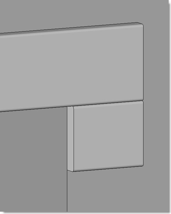

Im sure you guys have come across this question before but im a newbie and i cant seem to find something on here that fits. Im trying to put a frame around some artwork. The horizontal trim goes on with no problem because the profile of the trim is horizontal but when i want to do a vertical trim I only get this. Ive edited this profile by making it longer so it fits where I need it.. But that means i would have to make a new profile for every vertical peice that is a different length. I KNOW THERE HAS TO BE AN EASIER WAY! plus the vertical trims only schedule as 3"... even thought in my model they are 2' long. So basically i would like to take the profile used and rotate it about the 'Z' axis. I've read about people using wall sweeps and simple extrusion but i cant get it to work right... plus and it still does not schedule correctly.. im running out of time in this project.. please help a newbie out!! Hope someone can make sense of this rant!

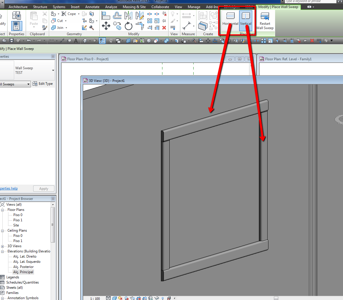

Faster... WALL SWEEP (horizntal and vertical)

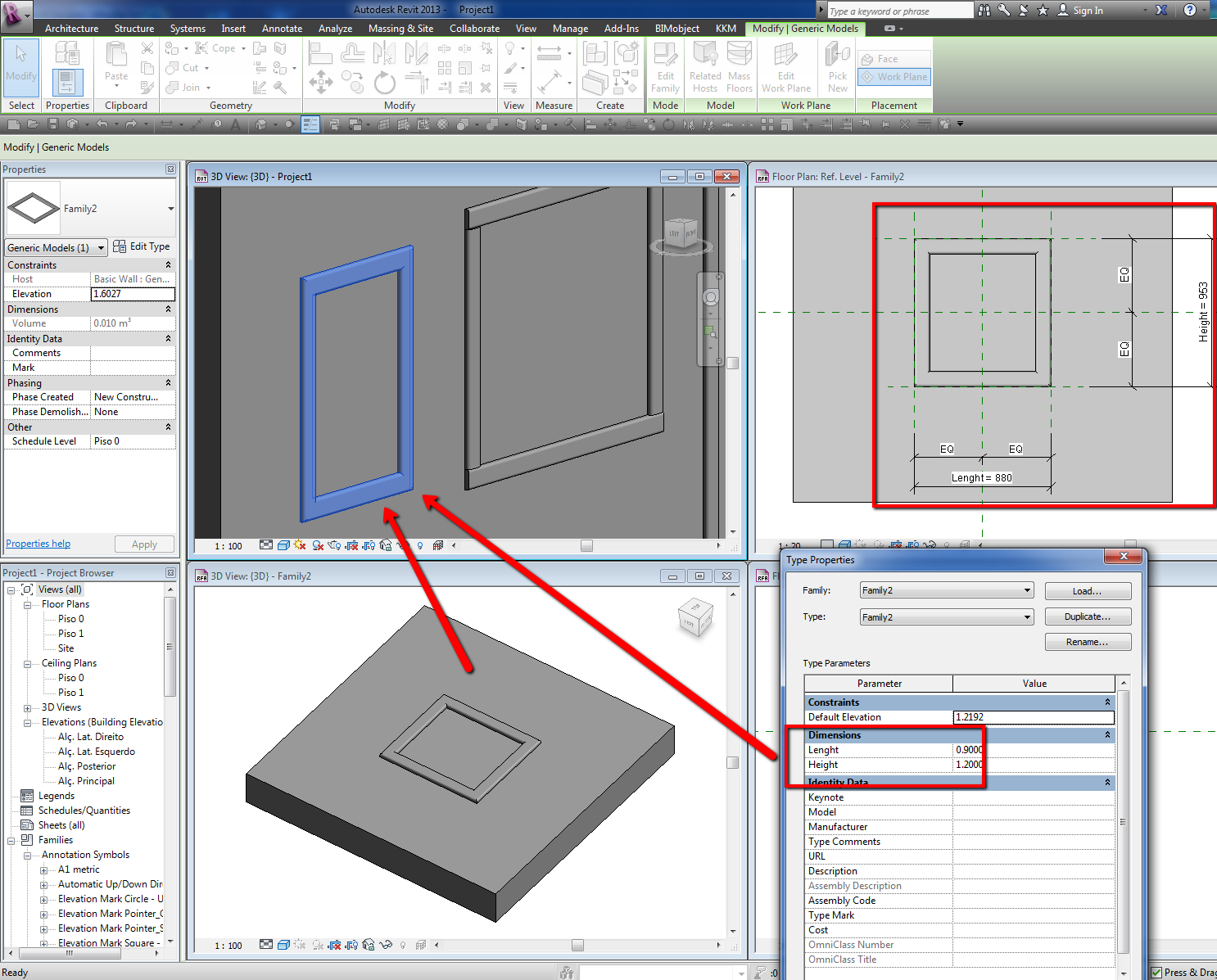

Or Parametric if you want, face based family...

Yes! graphically that is exactly what I need.. and i can make it look like that.. but now the problem is the schedule. It doesn't schedule.

OK the secont one is what i want.. as long as I can edit the length and width for each piece of artwork lol.. but scheduling is still an issue.. Typhoon you're awesome! i feel like I actually have some hope here.. lol
Tue, Jun 12, 2012 at 2:54:39 PM | Vertical trim ***PLEASE HELP****
We do our artwork as a face based, furniture family with Width Height that is parametric.  The trim automatically sets with the type based size that can be scheduled.
