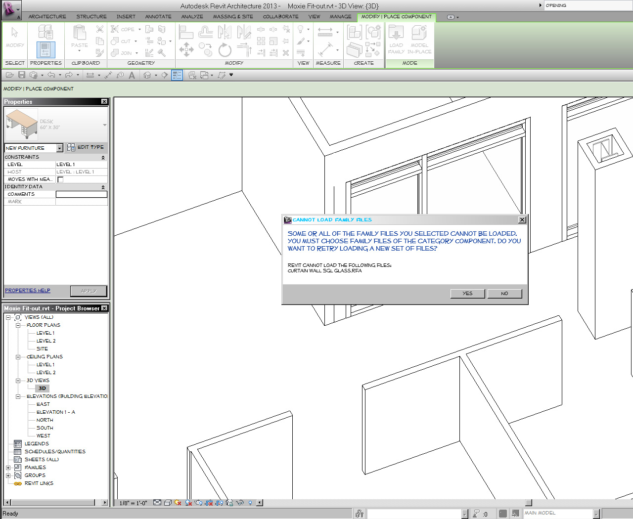

I'm trying to add a glass door to a storefront system (Revit 2013) and when I try to load the "single glass" family I get an error that Revit cannot load that Family.  This is how I have changed curtainwall or storefront panels in previous versions of Revit, is there a different way to do it in 2013?  How am I supposed to load these families into my model?

Revit still works the same way except it does limit family loading to appropriate views.  Simply change to an elevation view of your storefront, be in the view, then load your family.

dgcad - that is precisely how I have added doors and am trying to do it now... The problem is that when I select a glass pane, the only options I have are "glass" or "solid" panels.  I need to load in the glass door family so that it shows up as an option.
wwhub - I have tried to load the family in a floor plan view, elevation, 3d view, section... every time I get the same error:
"some or all of the family files you selected cannot be loaded.  you must choose family files of the category compontent.  Do you want to retry loading a new set of files?"
this is a standard family, not one I have created or edited.

If you go straight to the 'Load Family' tool off the Insert Tab (not from any other command or from the type selector or dialog box) it usuually doens't qualify the 'Category'. You are loading a family. It could be a detail component, door, window, curtain wall, profile  . . . . . . .
It's different if pick 'load family' from within a command sequence or dialog box.
Try this: Start REVIT and do nothing except pick the 'Load Family' tool off the 'Insert' tab. REVIT should not question the category ?? How would it know what category you intend to insert ? You should be able to insert any category.
Mon, Jun 11, 2012 at 11:05:13 AM | doors in storefront
This is simply stupid!!!!  Probably some of those programmers that came over from AutoCAD.
Goto the door tab, then pick load family.  S T U P I D !!!!  Not you - AUTODESK.

GENIUS!  (You, WWHub, not autodesk!)
and this explains some of the other problems with loading furniture etc that I'm having.  I'll have to play around with that stuff too and re-learn some new habits.  what a crock!
thanks for your help
