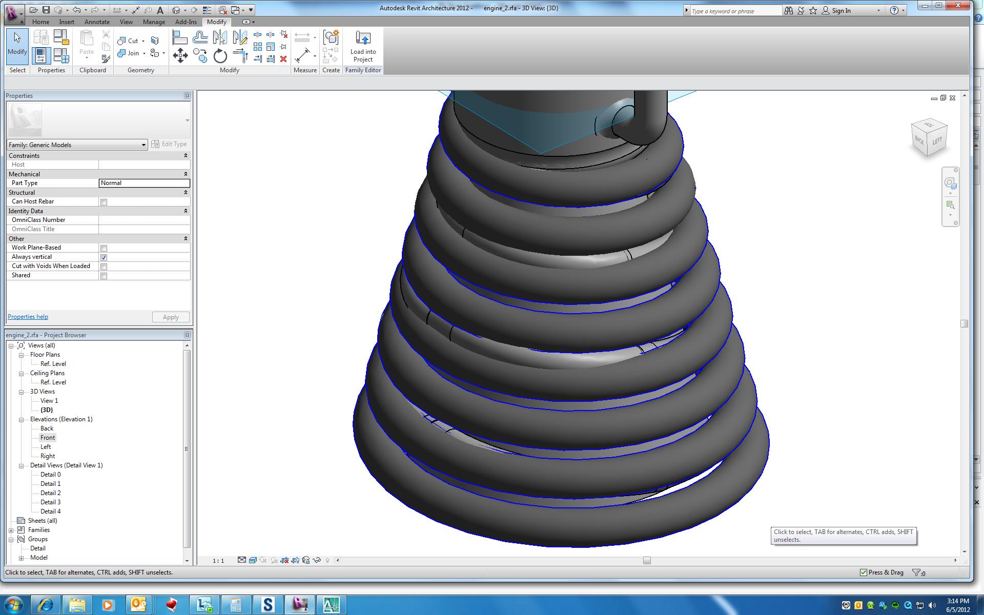

I’ve done it piecemeal but it doesn’t work so well. (See image attached)
Any tips would be appreciated.

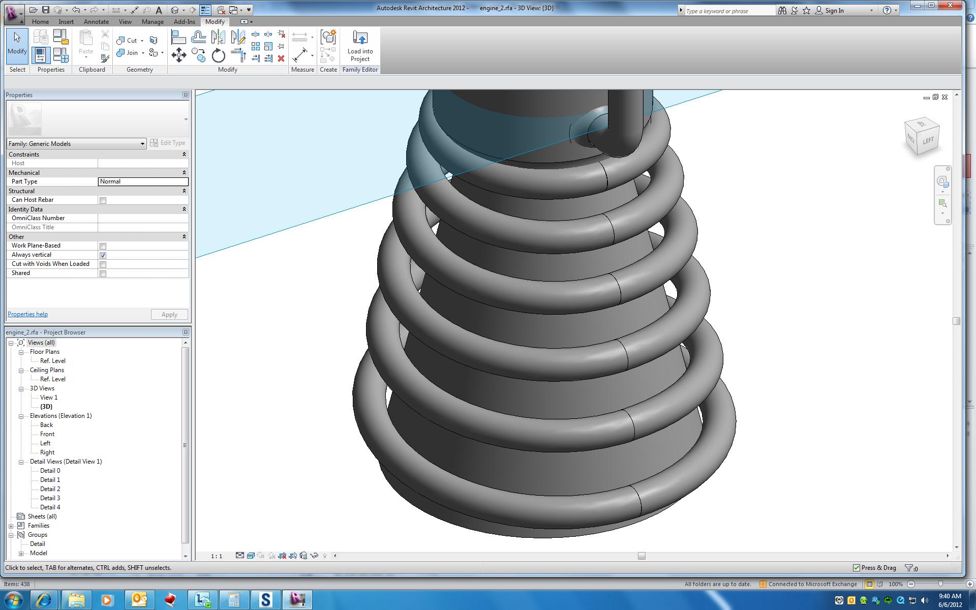

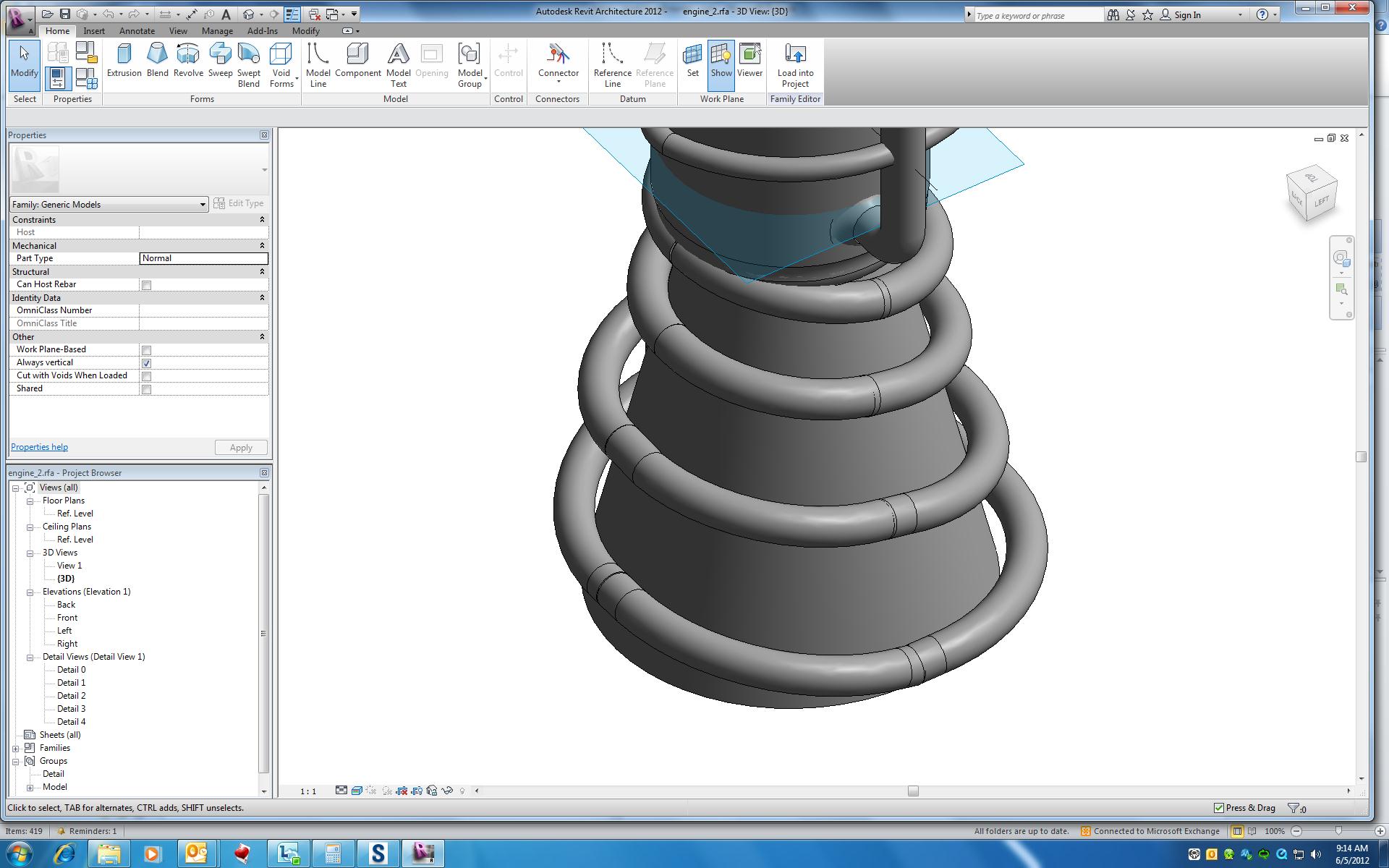

I was able to create the conical spiral in revit. First I imported the AutoCAD file and partially exploded the spiral plan view and used it as a template to trace over. Partially exploding the spiral elevation gave me the angle of the downward spiral. Using a sweep and creating a circular shape I was able to model half of the loop at the correct angle and then mirror that (X/Y axis) and rotate the loop (Z axis) about the centre of the preceeding loop downward matching the previous angle. Doing this over and over until I completed it as per the attached sketch. this is the only way I was able to get it to work so far in Revit. It would be nice if Revit had the Helix tool as it is set up in AutoCAD. Down the road version upgrades I guess.

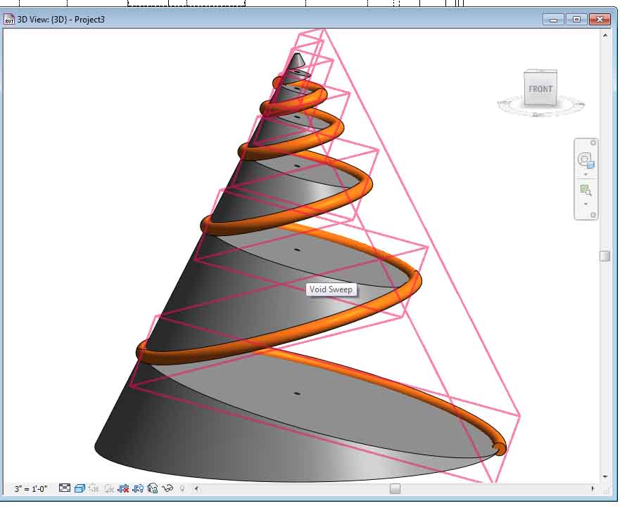

this could be done quickly like so:
model a cone.  model a jagged void (see pic.)  cut cone with void, use the lines of the cut cone as the path for a sweep, and voila; a tapered spiral.  (then hide or delete the cone.)  Not mathematically perfect since a spiral does not rise linearly in elevation, but it looks okay.
perfect tapered spirals would be best done as hemispherical-pathed swept blends.  not too time-consuming if you lay out the series of profiles in an elevation or section first, with detail lines.

That is a creative and interesting solution for the conical spiral. I wonder if it could be made parametric, though.

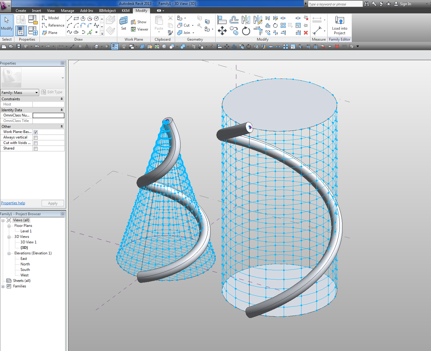

I posted this a couple of years ago: http://www.revitcity.com/gallery.php?action=view&gallery_id=11724
same process with a cone or a cilinder...

Parametric... divide the surface, turn on the nodes, create a spline by the nodes...

The jagged void solution is cool. Never thought of that.
