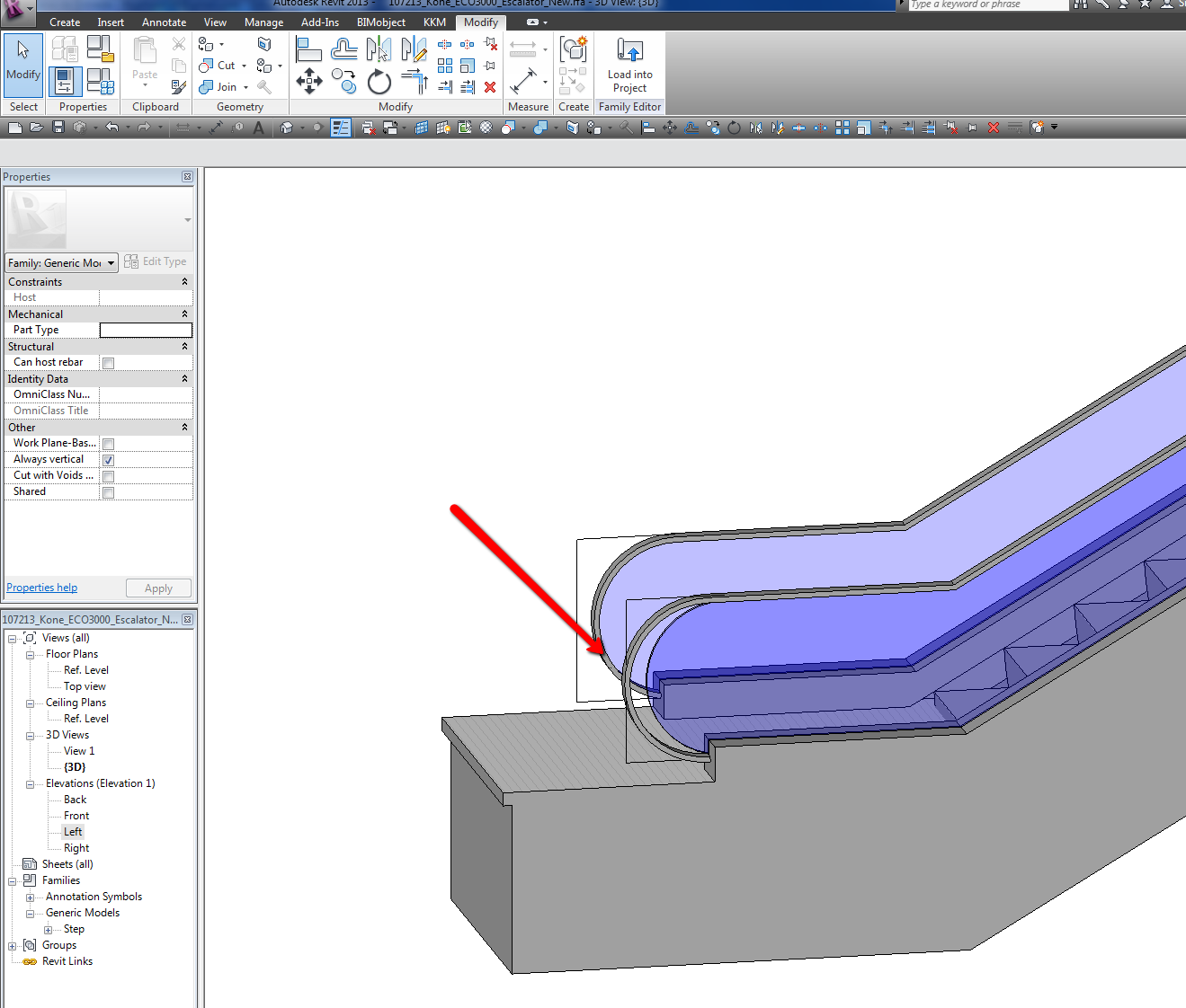

Hi All,
I'm having trouble to add these parameters and make it work, when loaded into a project.
can some-one here add these parameters...,or guide me. (i have marked them in RED)  i got this family from here itself.
My request is that these dimensions (need to be converted into parameters) are not fixed dimensions,
therefore i should be able to modify them independently.
Pls. see attached.
I'm Using Revit Architecture 2012
cheers,
W
Mon, Jun 4, 2012 at 6:16:20 AM | Escalator Help
Joined: Tue, May 22, 2007
5921 Posts
4 Stars: 205 Votes
CREATION FAMILIES RULE 101 - Create "Ref. Planes", create dimensions between ref. planes and not from objects, select the dimension and create the parameter, create obj. and constrain to ref. planes.
Good luck
Tue, Jun 5, 2012 at 9:47:24 AM | Escalator Help
bjwson
Joined: Sat, Nov 25, 2006
66 Posts
2.5 Stars: 3 Votes
thx. for the tip. i could do most of it. but if you see (in 3d view) the family i've attached, i need the handrail quadrant to be at where i have drawn the model lines....why am i not able to make it work. pls. help.
thx.
W
Tue, Jun 5, 2012 at 1:02:32 PM | Escalator Help
5921 Posts
4 Stars: 205 Votes
Edit the PATH and sketch like you want.
Wed, Jun 6, 2012 at 12:50:55 AM | Escalator Help
bjwson
66 Posts
2.5 Stars: 3 Votes
thx. let me try.
