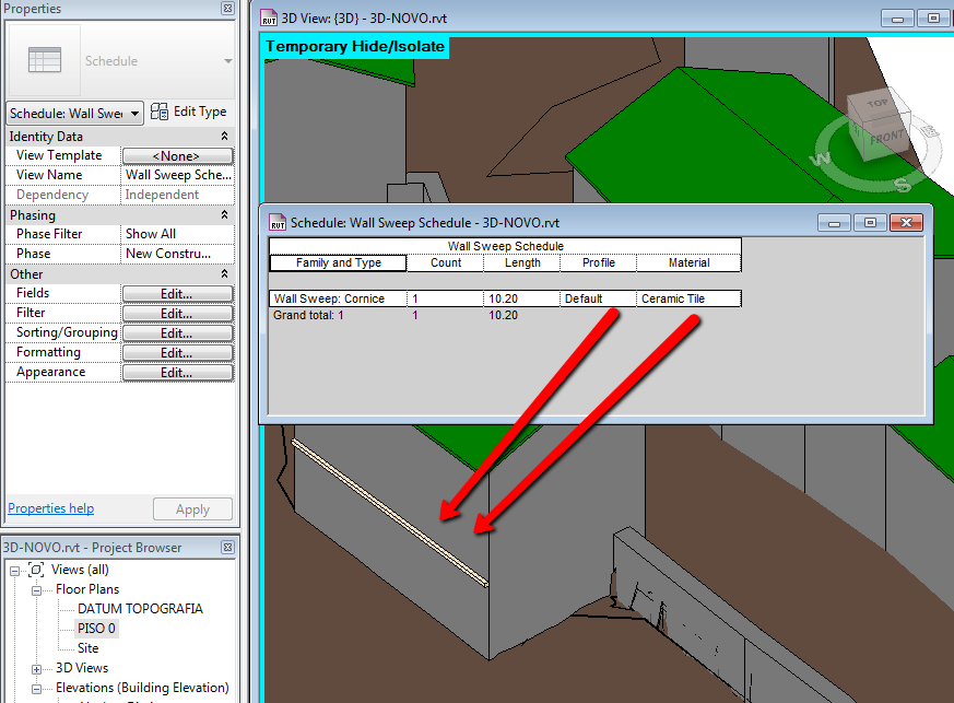

I am using Revit 2012.   I have created a profile family that I am using for Baseboard molding. I have this profile applied as a wall sweep.    I want to be able to schedule it in a Material schedule.  Is this possible?  Everything else schedules in the model except materials that are applied to profile families.

Use Schedule / Quantities > Wall Sweeps

Thanks for your help.  It would be nice if we could schedule multiple Categories such as Wall Sweeps, Specialty Equipment, etc within the same schedule?  I don't think this is possible.
