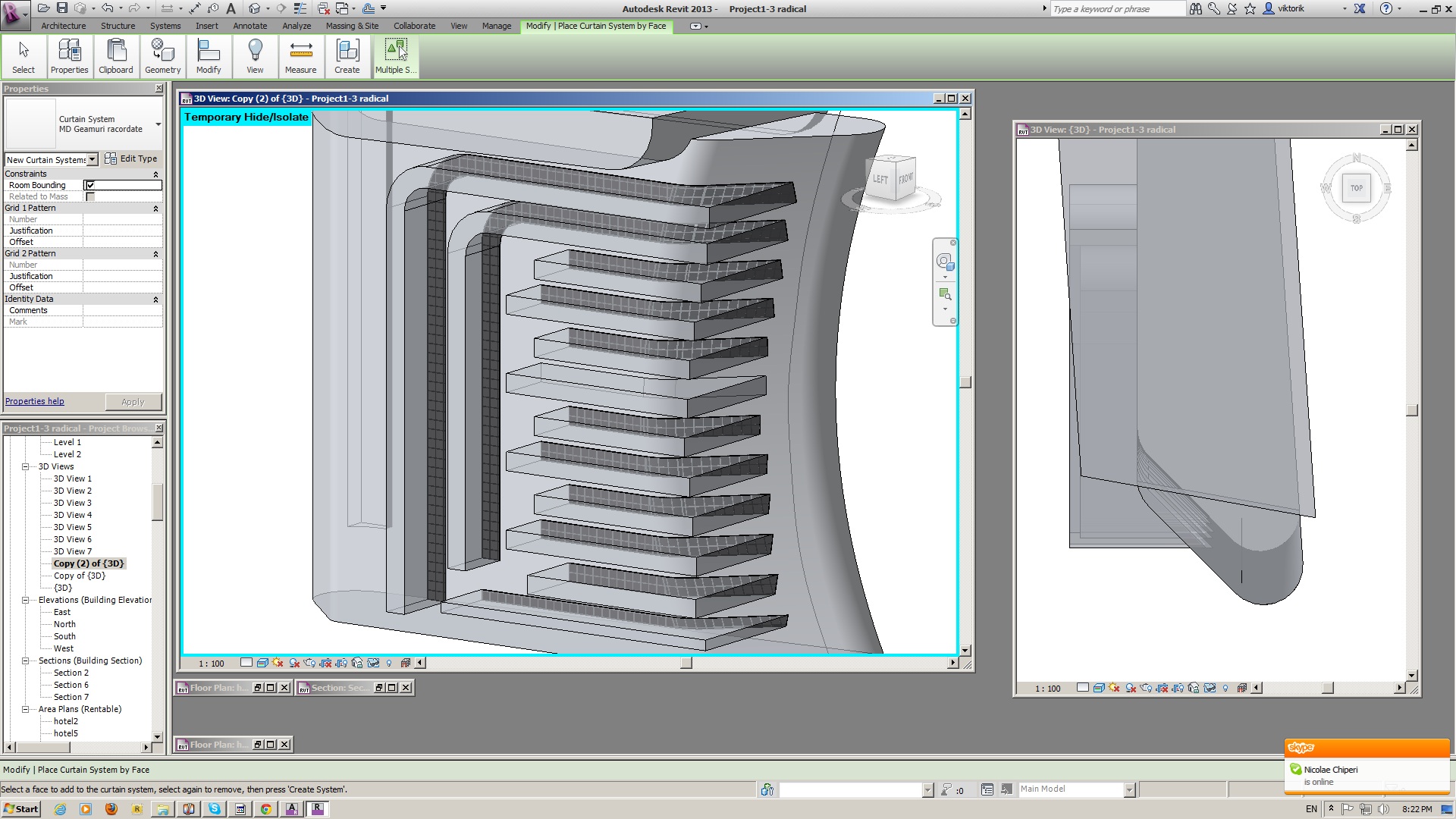

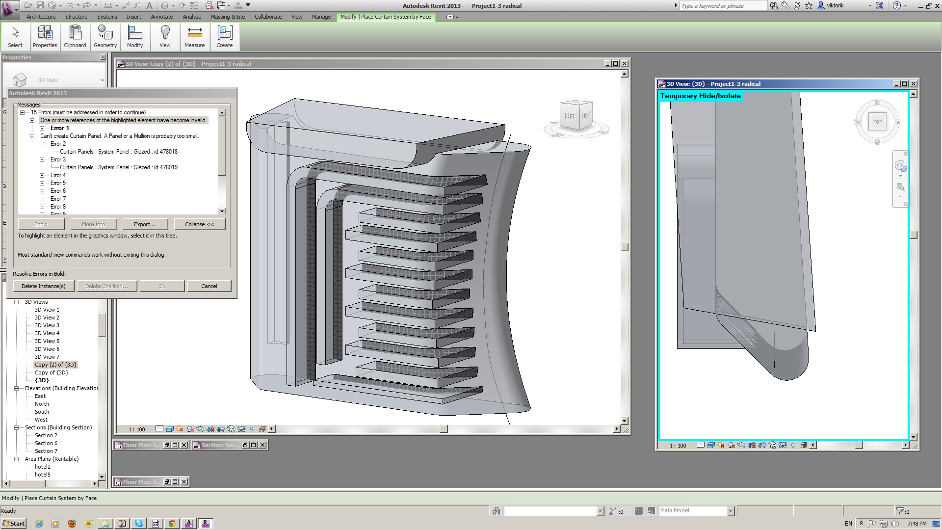

I have cutted thin volumes with that big , at tangent faces I made glazing panel/ curtain system by face but one of them make that , what's wrong , where to find the problem, what to change, it cuted but i doesn't want to make curtain system , it show it but after clicking cancel or delete it disapears ... all that in one inplace mass...
http://img21.imageshack.us/img21/5905/forumrp.jpg
Mon, May 28, 2012 at 12:24:44 PM | Curtain system > glazing panel matherial
viktorik
Joined: Fri, Jul 1, 2011
43 Posts
this at the midle , is capricious

Look the error, "A panel or a mullion is probably too small"... try to create that by zone, one by one until you have the error and check what is wrong....

Thanks, you saved me, yes I had selected 3 zones/faces at a time, but when now I selected by step creating 3 systems not one , it jumped over that error, some messages appears but that don't matter , it works ...   My second revit student-sketch-project,   and I like that program more an more ...
