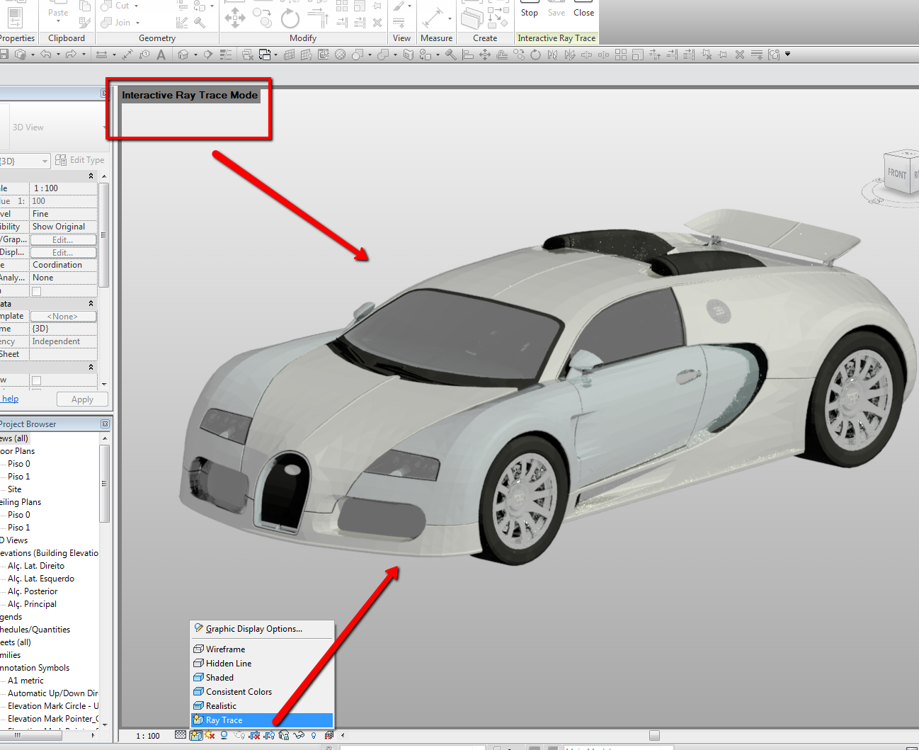

"For time reason i would to like to present the file in a color , but not rendered." - Did you try in a 3D view with "Ray-trace" mode?

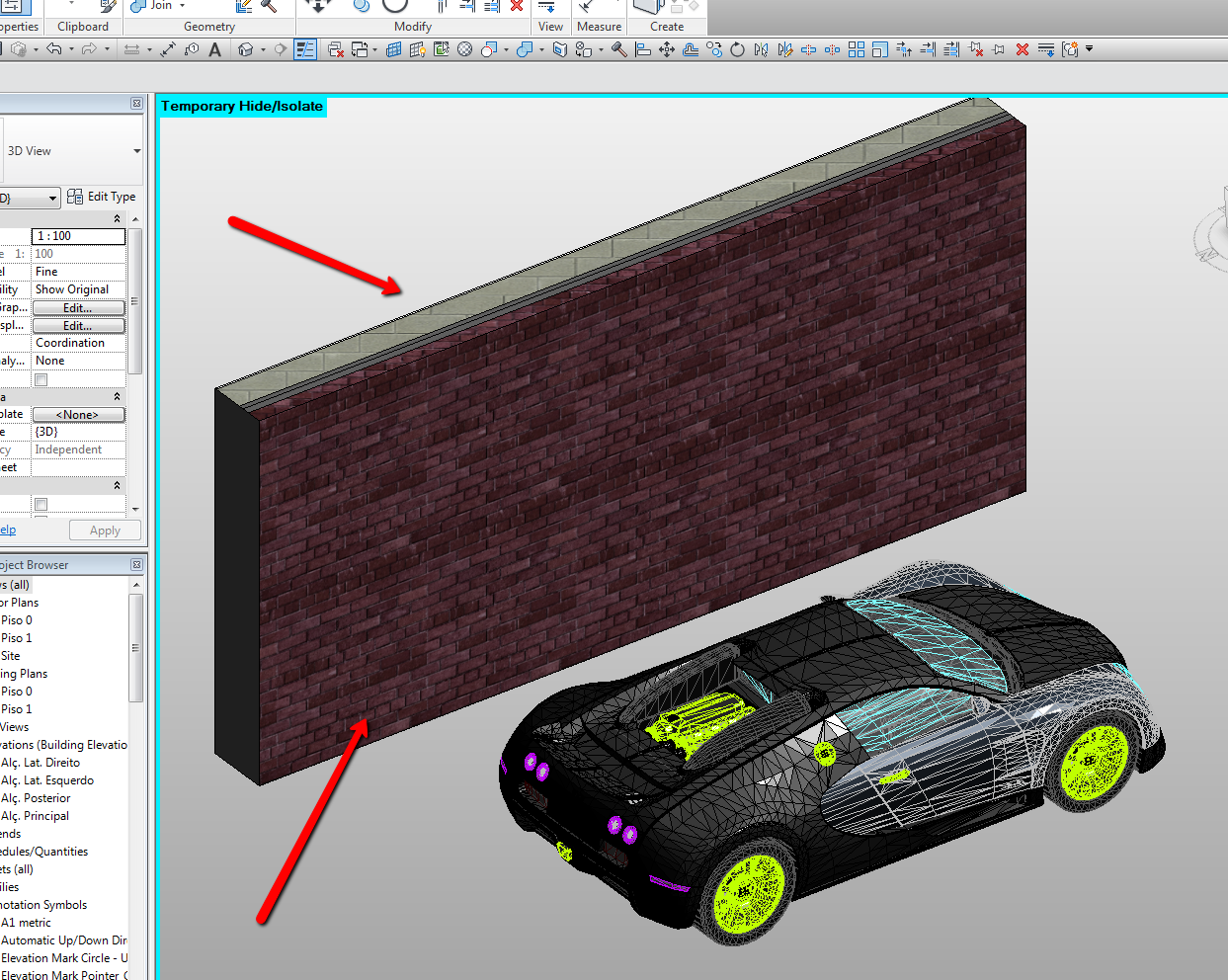

"I also would like to present some pictures on the wall, but if i import the jpg i can not see anything.." - Createa "DECAL" for that.

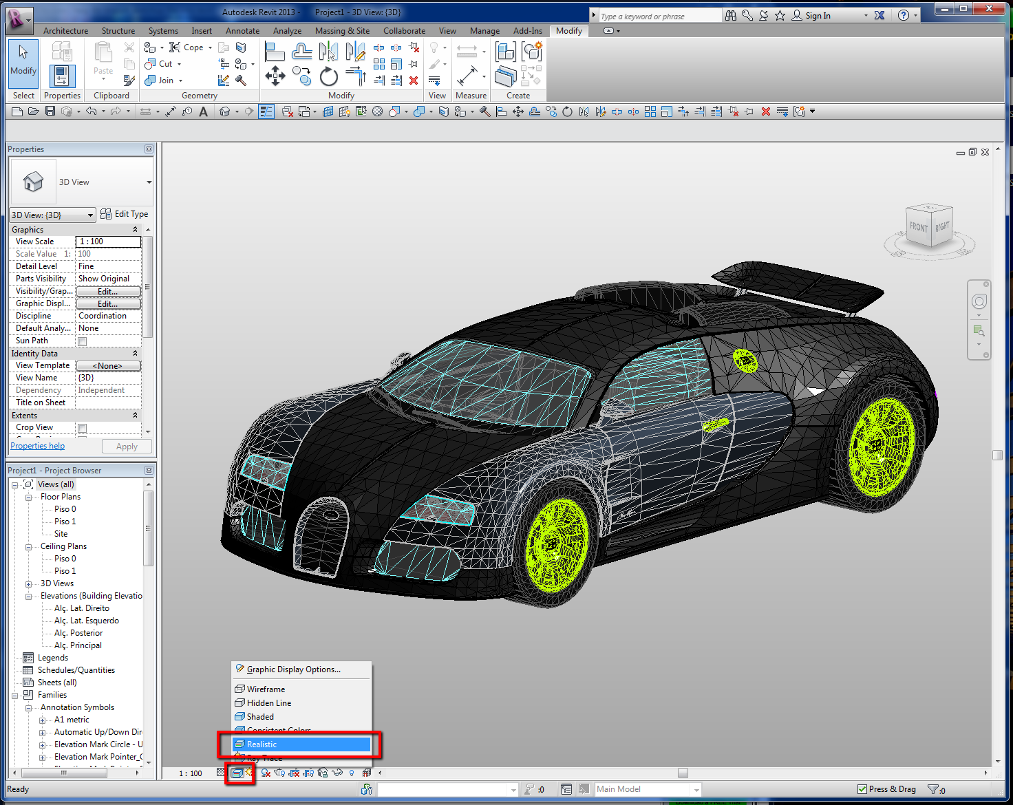

"You cannot compair it with skecthup, but i like the way skecthup works with the materials, you can make an screenshot and the materials are visible." - No, you can't compare these two softwares, Revit is a BIM software and sketchup isn't, so, they aren't comparable but change the Visual style in the view you want to "Realistic" and you will see the naterials in that view without rendering.
