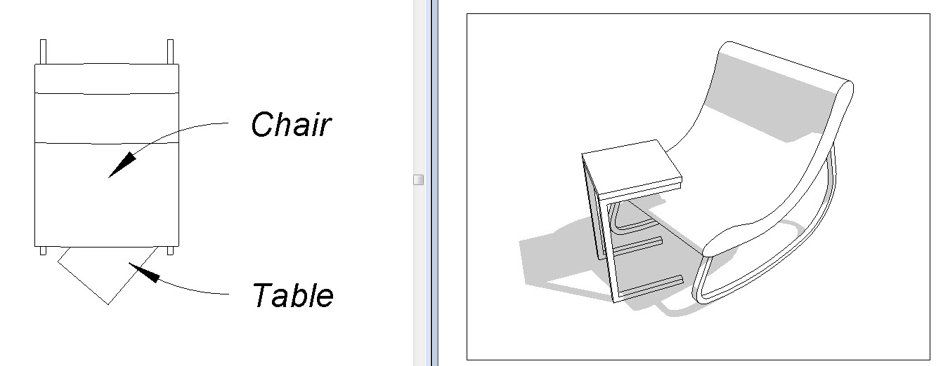

I am talking about within the PROJECT. I attached a snip and as you can see a laptop type side table is being shown beneath the chair when in reality it is above it of course. The most frustrating thing is that in other instances this table will appear above other chairs as it is supposed to. There doesn't appear to be any rhyme or reason to how this works so hopefully someone here can help.

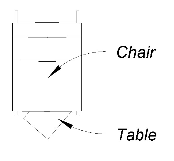

Sorry again... Let's back up a bit and think of this as a general question... if every family in a project has only masking regions visible in plan view... how does Revit determine which objects are above or below other objects?
back to my specific case... yes, they are two separate families in a project. They also both sit on the same floor plane. I attached another pic for clarification. Could you explain your offset comment a little further?

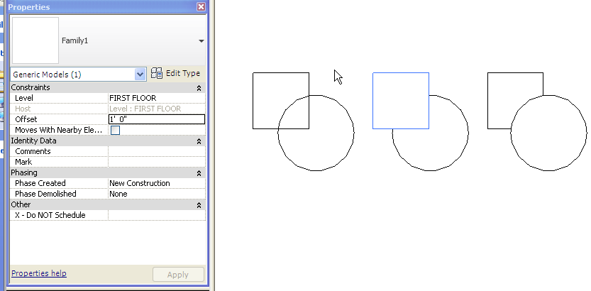

Fri, May 25, 2012 at 9:26:55 AM | Masking region hierarchy
#9
Look at image... Two families each just masking regions.
  • First pair - both at same elevation in the plan - they both show
  • Second pair - square is offset and masks circle - look at properties box
  • Third pair - circle is offset above the square.
Now do you understand?

Ah, I do see what you are saying now... the reason I didn't understand is because that option is grayed out in the family instance parameters. Is this because I started with a generic face based family? And is this impossible to change if using face based families?

I thought the second image split screen of the table and chair made it pretty clear I was referring to two separate and independent 3-d families in a Revit project represented by masking regions (drawn within the family) in plan views.
