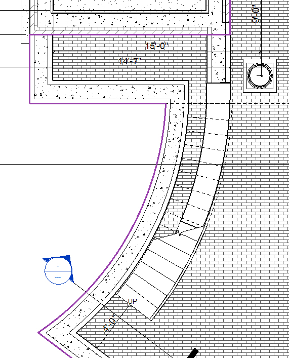

Im using revit arch 2010... Created a wall in place to get a curved slopping down under the curved stair.
Is there a way to apply the stone pattern and the other wall properties (which is concrete structure with stone finish on both sides) to the in place wall so it reads as one single wall?

You could join your walls and add the material to your in place wall.

Edit that in-place wall, now create 3 walls, not one, with the thickness and material parameters for those walls like you want.
