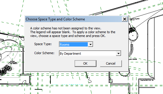

Hello,
I am using Revit Architecture 2011
Does anyone know a way to be able to choose a different 'Space Type' when creating a Legend? i.e. selecting my topographic sub-regions instead of the default 'Rooms' (please see attached picture.
I want to create a legend which references the colours I have used for my sub-regions.
Thanks in advance,
Kieran
Thu, May 24, 2012 at 8:29:18 AM | Legends
Spaces and rooms can have annotative color fills and that is the legend you are trying to work with.  It is not meant for model elements.
You could create area plans and color fill those and use a legend for that, otherrwise, not sure what you can do.
