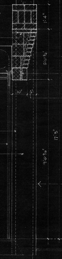

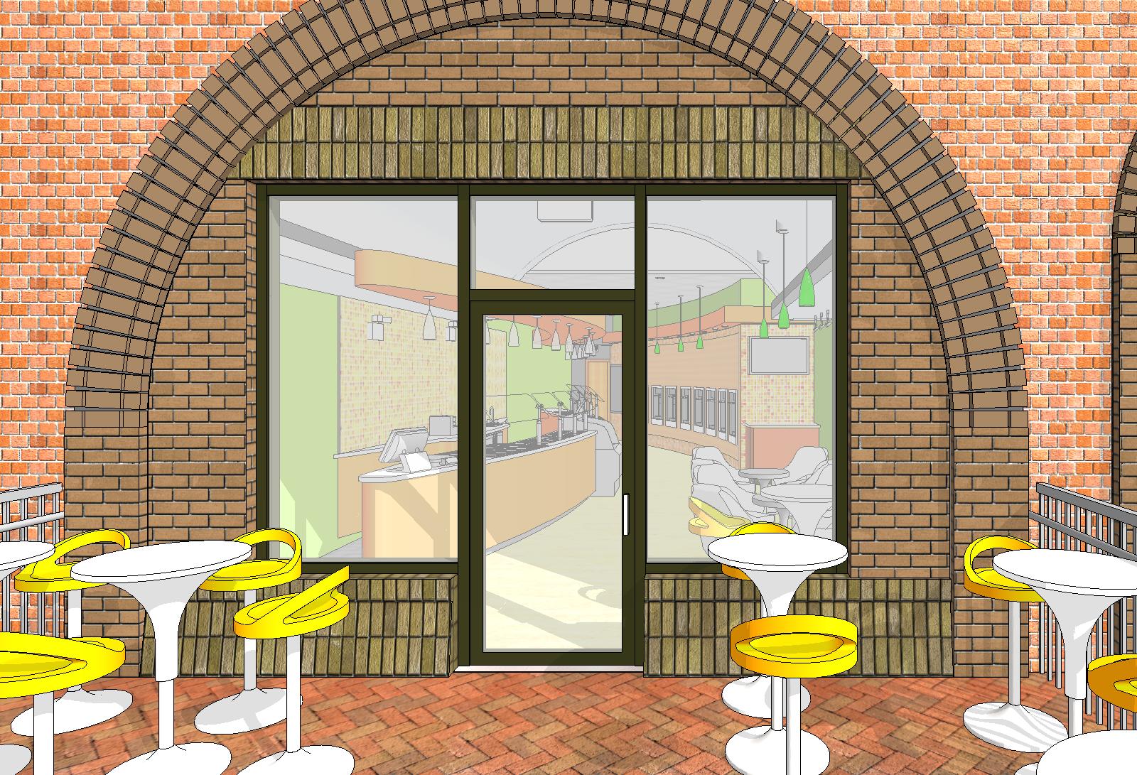

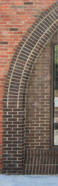

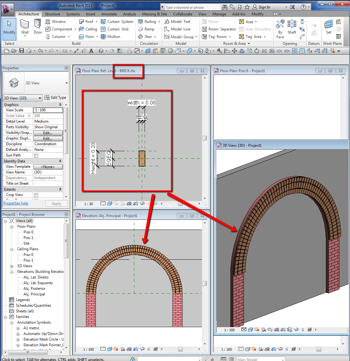

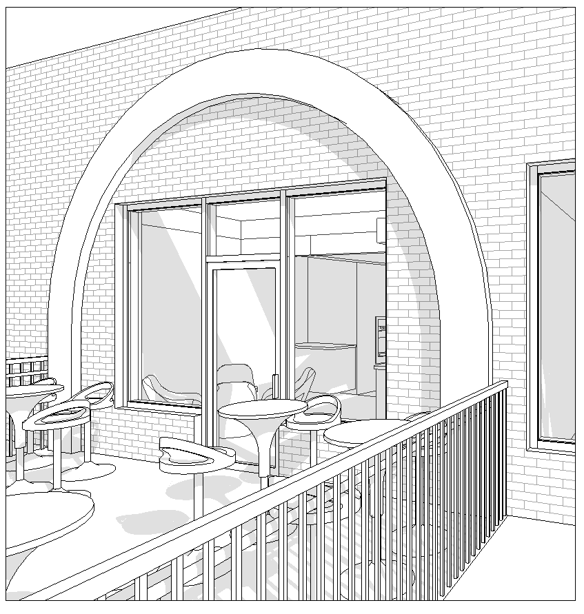

Hi Guys,
So I'm working on a project with lots and lots of bricks assembled into interesting profiles. This is an existing building. If they didn't win a brick manufacturer's design competition I'd be surprised.
I attached a wall section here along with a photo, an isometric view and a perspective view.
Questions:
1. Ideas for radial brick work
2. Ideas for the brick sill and wall below at an angle
3. Was thinking of making a wall with sweeps for the projecting brick work
5. Better ideas than an imbedded wall with a profile to get the arch modeled
Thanks!

Array Radial for the arc, create a generic model face based family with instances parameters...

Hi Typhoon - thanks I followed your advice and it worked pretty well.

I guess the next thing might be writing an equation to calculate the number of bricks in the arch give the radius and making that part of a family.
