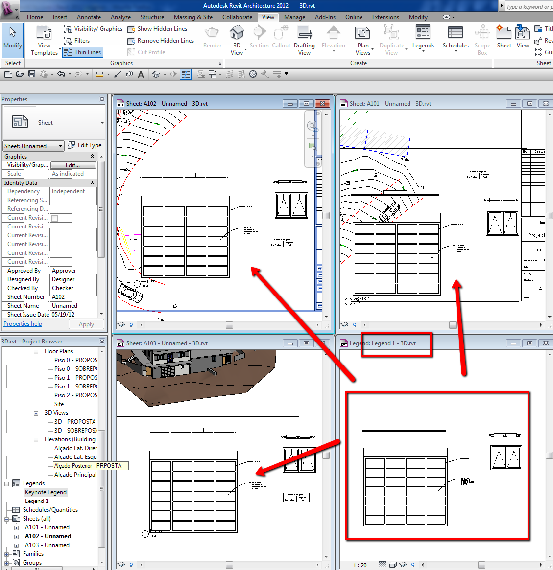

I'm working in Revit 2012 (about to move to 2013, so this may be fixed there), but I am having an issue with placing a legend view on multiple sheets.  Basically, I made a "general notes" legend, and would like to display it on all my floorplan sheets.  Once placed on a sheet, the legend view disappears from the "views" dialog box when adding a new view to a sheet.  I've even tried copying the view from one sheet, but I get an error about a viewport title not being able to be copied.  I thought legends were supposed to be able to be displayed on mutliple sheets.  Thoughts, anyone?

You are doing something wrong because i don't have any problem with legends, they show in all plan i want.
