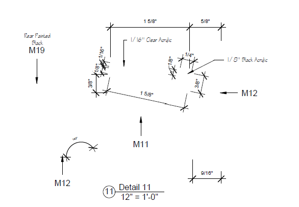

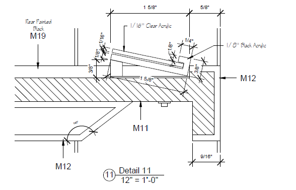

I was having the same problem with a specific detail then
I switch from vector to raster and it worked! I switched back and voila it worked again.
