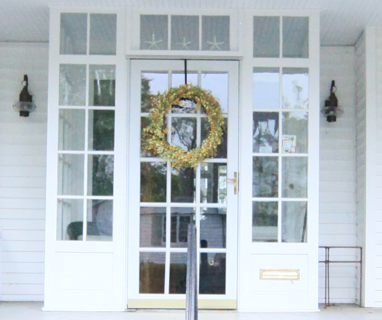

This is a traditional old home with a glazed vestibule.
I am using Revit Architecture 2012.
Any thoughts on walls, windows or curtain systems?
Thanks

I would create it as a cutain wall
Tue, May 15, 2012 at 12:21:47 PM | How to model a residential vestibule
This is not a curtain wall candidate.  This is a door with sidelites and transom.  You can find these in our downloads like this one: http://www.revitcity.com/downloads.php?action=view&object_id=1548
You can also find individual doors and seperate sidelites.
In your library under doors is this one: Single-Raised Panel with Sidelights.rfa and all you have to add is a transom lite.

WWhub- How would you create the other 2 sides of the vestibule?
Wed, May 16, 2012 at 8:06:49 AM | How to model a residential vestibule
I don't know what they look like, do you?  They could also be simple sidelites.

You can see the left one in the picture that is attached.  You would create the whole vestibule out of sidelights? I guess I wouldn't have thought of that, a curtain wall for the sides seemed right to me
