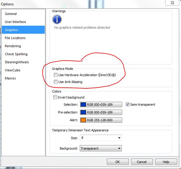

Hi - Just started using Revit 2013 and it seems to run really slowly on my computer (windows 7 64bit, 12GB RAM, 2.67GHz, NVIDIA Quadro FX 1800 graphics card).
For instance it takes like 10 seconds if I try to change the crop region of a basic plan view.  Multiple other slow downs as well.
Does anyone have any ideas or settings I should adjust to make this work better?  Revit 2012 gave me no such problems.  Could this problem be because I converted a file created in Revit 2012 to 2013?  I recreated the central file and have restarted multiple times to no avail.  Maybe I need a better computer??
Any help is greatly appreciated.
Thanks.

how large is your project? the machine sounds ok, the gpu is a little low end. possibly a driver issue, go to Revits/Options/Graphics and see if it detects any issues

Thanks for the ideas.  Revit is warning me about "Older video card driver"

UPDATE - My Revit 2013 is working much better now.
IT people updated my graphics card NVIDIA Quardo FX 1800 Now with Version: 8.17.12.7642
The other thing that really helped was a setting in Revit
Go to the Options menu (under the purple 'R')
then under "Graphics"  >  Uncheck both boxes for "Use Hardware Acceleration (Direct #D)"  & "Use Anti-Aliasing"
Not sure what those options do, but it seemed to work better after that and I am running it without the slowness issue.  Autodesk seems to have picked up on this issue, because I watched a webinar last week about the upgrades to Revit 2013 and the presenter mentioned that turning off these 2 graphics settings could help proformance on some machines.
