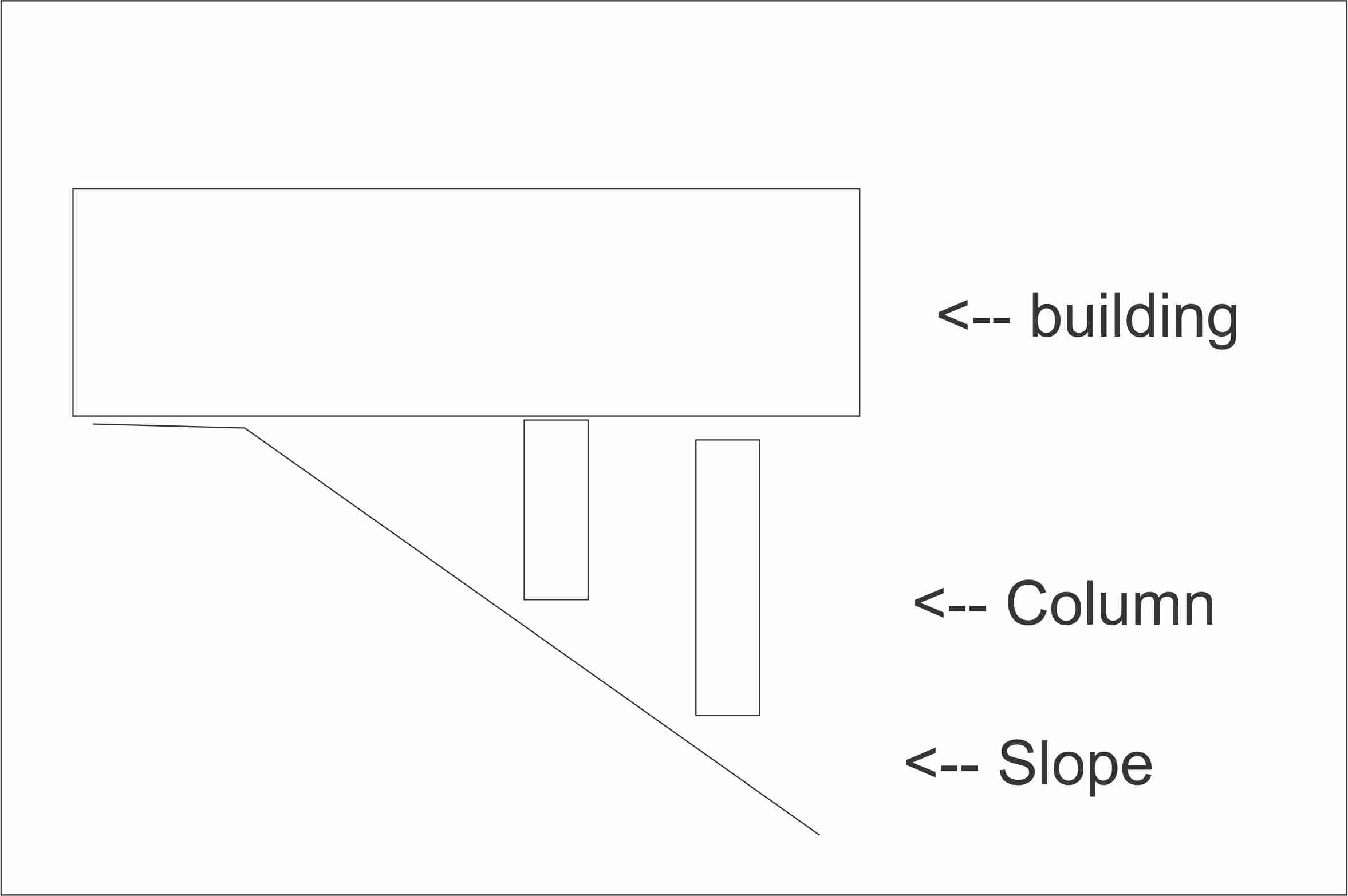

Hello people,I'm a rookie with Revit, to tell the truth I used to use the CorelDraw to draw mith stuff for college, but thats past. I've done the Infinite Skills for Revit 2011 but I still have some doubts about the software.1 - I want to creat a round area uon a slope, but how to put a collumn to hold the structure? If the construction base starts is 0 level and than starts to decline. I'll try to draw it here to make it easy to explani___________               |__________|        <----- Construction. I want some columns holding it, ---\     \      \                           \               <----- Slope        \         \
2 - the other question is, wich tool I use to model a round bench?Thanks a lot, everybody!

curse! The forum destroyed the perfect ( lol ) drawing that I've done.
I'll put a drawing here to help you to help me! ahhahahTks again

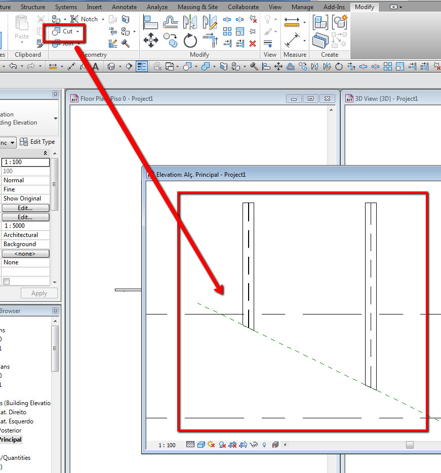

A simple way, use a ref plane in a elevation view then use the CUT tool to cut your columns
