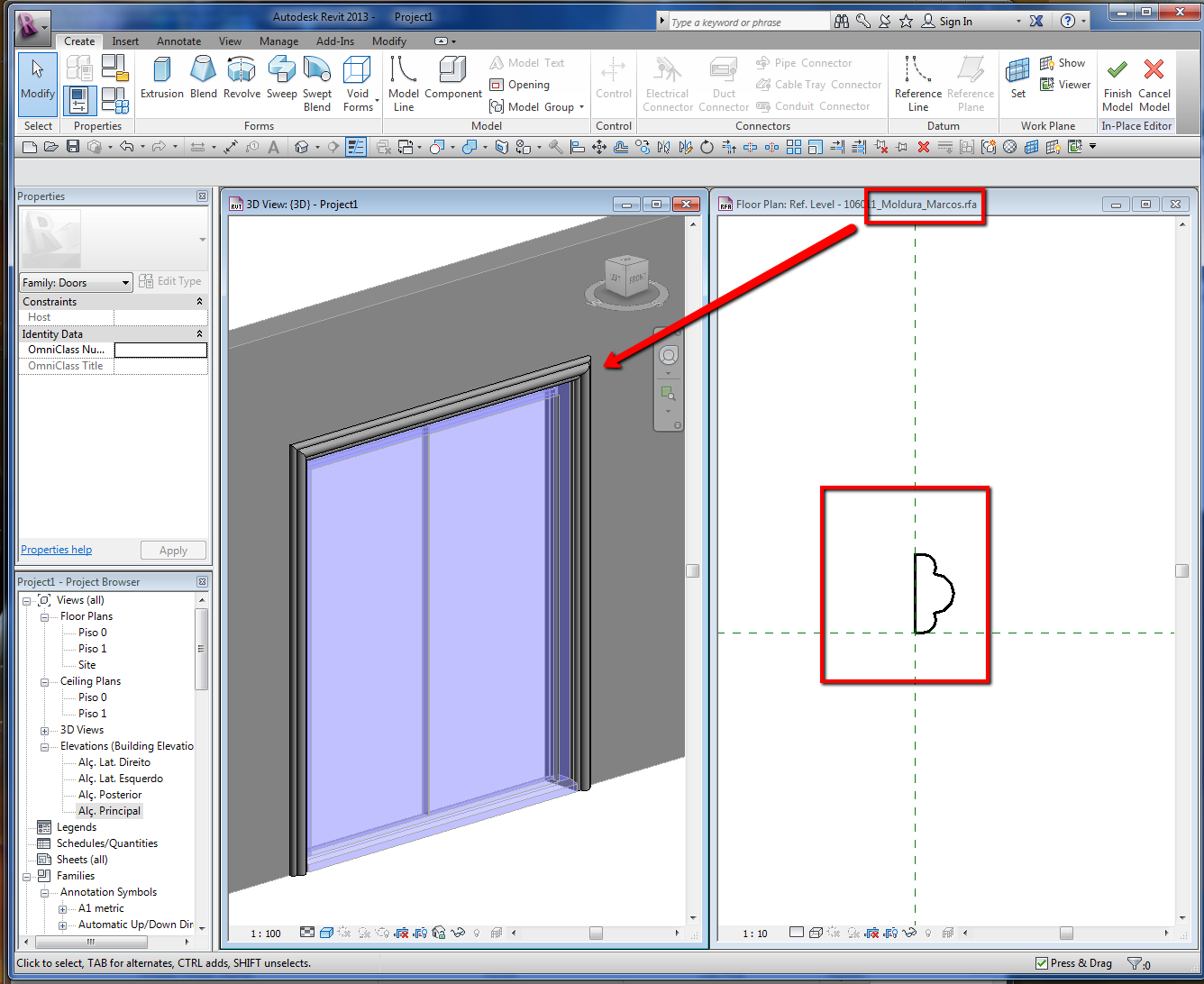

Hi all,

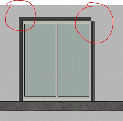

I'm trying to put some sweeps around a door and some windows hosted in walls, after dimensioning the sweeps I join them and got a nice 45º joint, but just in one side. How can I do to work on each side?
Thankyou in advance.

Why don't you create that "Sweep" INSIDE the family?

You don't understand, Or you create that with an in-place and use that profile with a sweep OR you edit your door and create that sweep INSIDE the family, so, when you load that family you have that profile attached to that door (or windows, that's the same).

Here you have: http://screencast.com/t/S9u4EhYeLB
