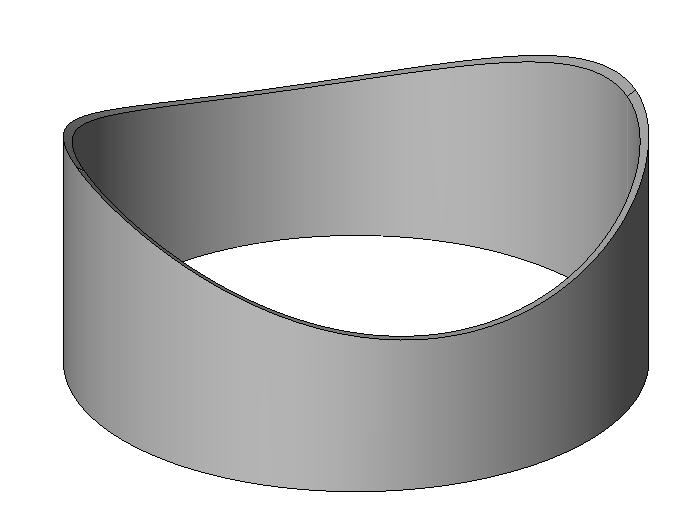

"That we can add a profile to a curved wall? If I create an extruded roof and project a curved wall to that roof it works!!! but I need just need the curved wall with a profile."
Draw a reference plane (instead of a roof), and attach the wall to the reference plane.

You can also edit a curved wall by massing first, then creating a void to cut the mass in the profile you want. Picking "wall by face," then re-editing the mass and "cut geometry" with the void you created for the mass to cut the wall, as the wall will follow the original mass and won't be complete til you "cut geometry" on the wall.
