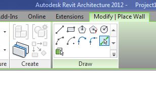

I was watching a webcast about revit for interiors, and I was surprised when the presenter linked to a CAD drawings and was clicking on the walls which transformed immediately to 3D! I didn't know we can do that with Revit. I always traced on top of walls to create the revit 3d walls. Here's the link incase anyone is wondering what Am I talking about. http://usa.autodesk.com/adsk/servlet/oc/offer/form?id=18472993&siteID=123112&ch=EM&src=AEMIV&mktvar001=461701&mktvar002=461701
it will ask you to fill out a form to be able to see it (which I don't like) you'll have to redo the form if you closed the window by mistake :s
The thing is that I tried doing that in Revit, but couldn't find out how she did it..how can you create the walls in Revit from a linked CAD dwg. without having to trace over the cad walls the traditional way? Am I missing something? :S

I did not watch the linked video but I would guess she used the pick line tool.

Yes she is just using the pick lines tool

I know dinosaurs that like to do SD in autocad and as they draft their designs I've mocked them up in Revit. They are always blown away that I can recreate their linework into a 3d model in minutes. My secret... If they arent already polylines in cad i convert them, then in the wall command in Revit I select pick line and hover over different areas while pressing Tab until the entire area highlights. BAM!!! instant wall layout.

Yeah that's what she was using. I tried it and it worked. Thank you all Smile
