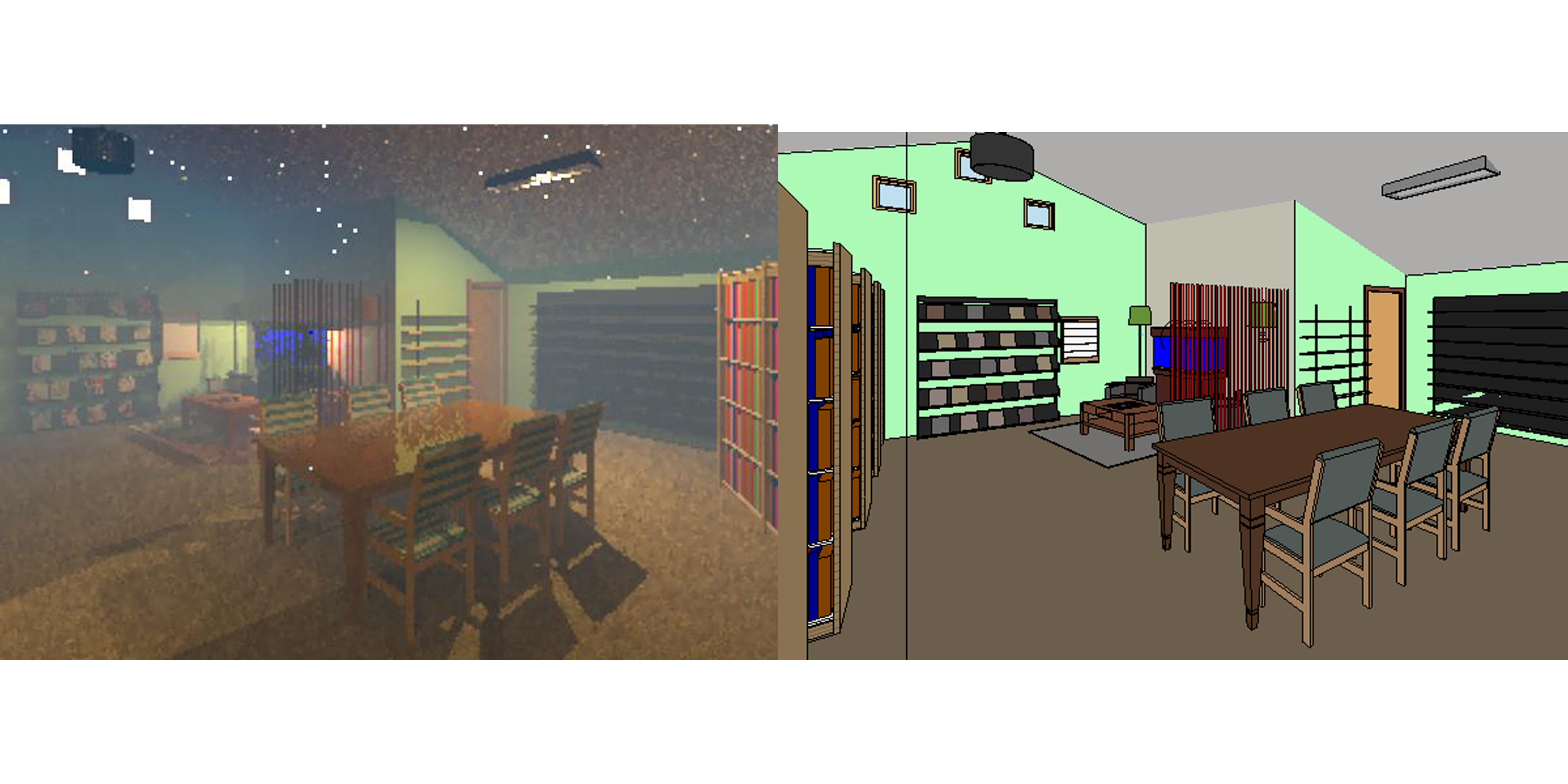

I've tried everything I can think of, but my lights wont render. Only one inlear light I downloaded from here is showing up lit. The pendants and floor lamps aren't rendering. I tried changing the intensity but that hasn't worked and they are all saying they are on and it is not a ceiling thing. please help!

Is your light source behind a lens?  Is the material of that lens transparent?
Is your light source above the ceiling plane?  Did your light cut a hole in the ceiling?
Does your light family actually have a light source in it?
